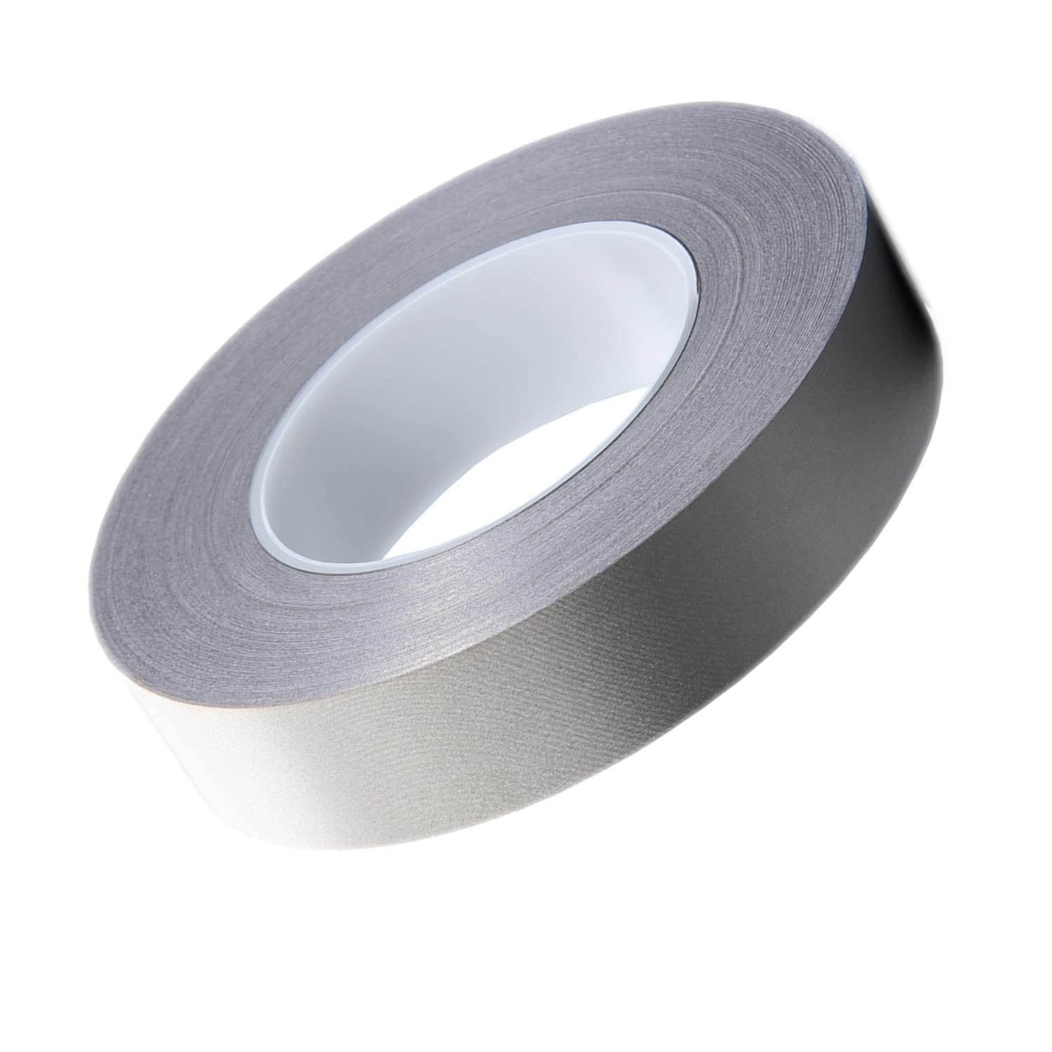

The issue that is happening is that there may be interference from the vacuum pump that is causing connection issues with your FarmBot. In some limited instances the vacuum pumps are causing excessive electromagnetic interference and it is causing the FarmBot to disconnect from the Wi-Fi network which triggers an emergency stop.
I would suggest that you wrap the power wires to the vacuum pump with EMI shielding wrap. If that doesn’t solve the issue I would suggest that you wrap the entire vacuum pump with EMI shielding wrap and that will likely solve this issue.
EMI Shielding Wrap or something similar will work.
Apologies for these issues, but they are able to be resolved with some shielding.
You may, if required, earth the shield as well. See:
