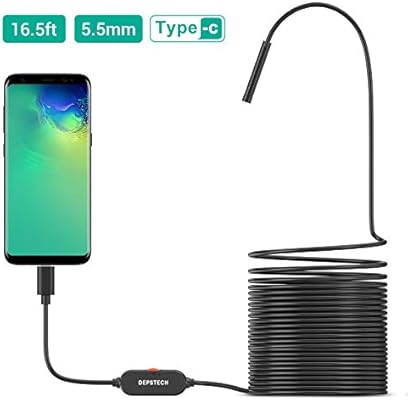

I wonder whether this micro usb camera would work
Bummer that the lights are not controllable via software.
