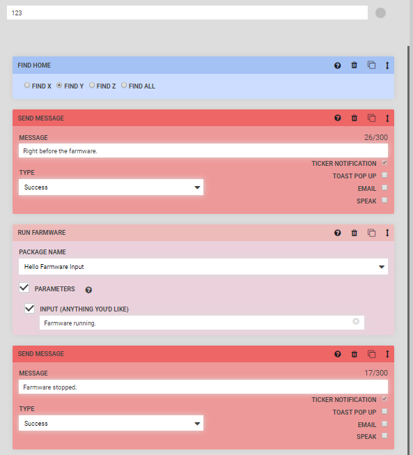

Got it working again, but no clue how. Yesterday evening the farm event triggered a sequence where the farmware is used and it was running through, but not completing the sequence, so the FIND HOME step that is located after the RUN FARMWARE step was not processed. With that in mind, I’m not sure if the sequence is still running in background and may cause system instabilities.

Looks like all farmwares are having this behavior. The RUN FARMWARE step makes the sequence flow get stuck when the farmware is finished. Steps to reproduce below.
