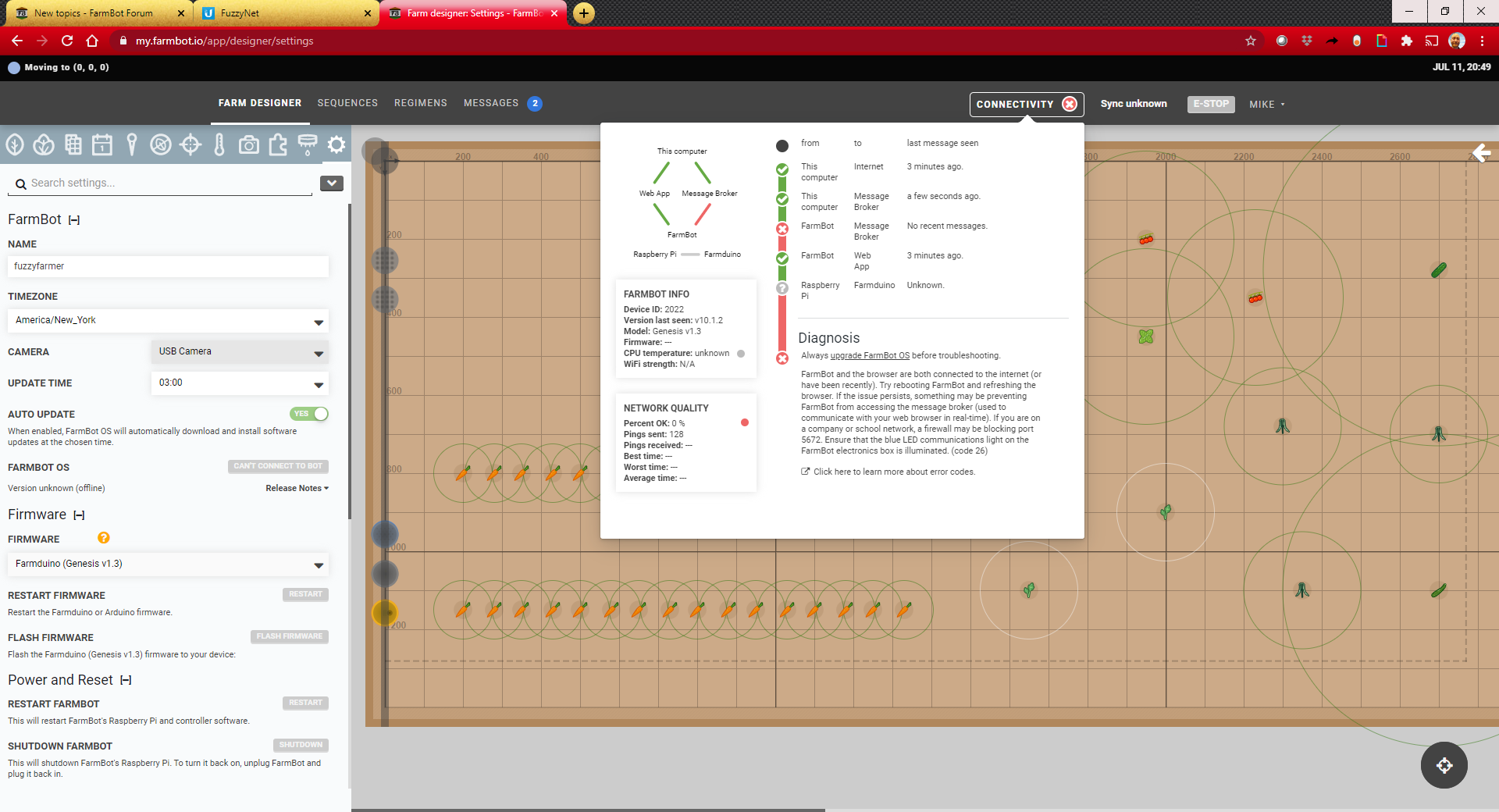

I’ve been having FarmBot Message Broker connectivity issues for the past 24 hours, consistent across reboots. Internet connectivity is A-OK (see below). Could my issues be related to the new OS release?

@fuzzynickel Are you absolutely certain there were no changes to your local network in the past few days? Is your device in a corporate / school setting? If so, have you contacted IT administrators to verify that there were no policy changes recently?:
- We’re not seeing a spike in these sort of reports (number of devices that are showing this issue on the production server is in the single digits)
- On the server side (our end), the logs are simply saying that the client connection was closed unexpectedly.
- On the device side, when SSHed in, the device is saying the the connection timed out with no response (but usually after a brief connection to the server).
I am going to email our AMQP vendor to see if they have any ideas. In the mean time, an interesting experiment would be to try unplugging the Pi from the electronics box and re-configurating on a different ISP to rule out LAN configuration issues.
