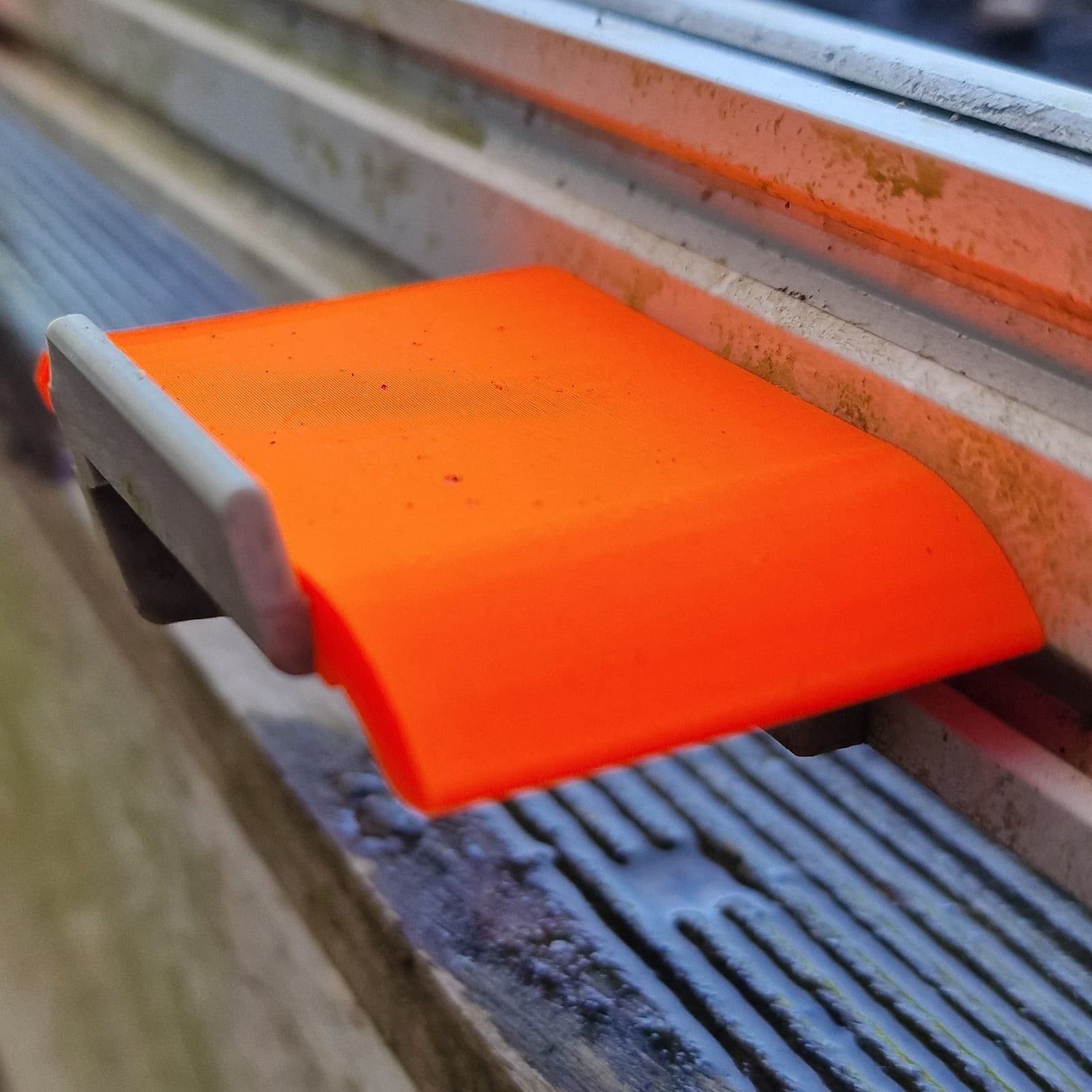

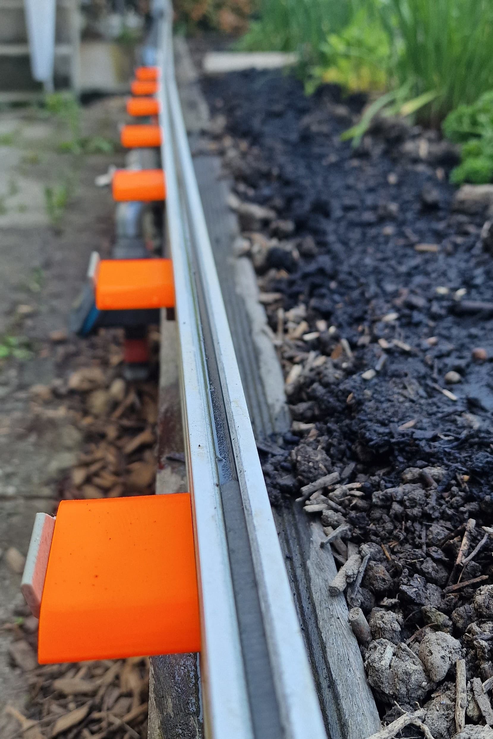

To address this, I designed a small clip that attaches directly onto the cable carrier supports. The purpose of the clip is simply to smooth out that edge and prevent the links from getting stuck.
Since installing it, the movement along the X-axis has been consistent and the issue has disappeared.
