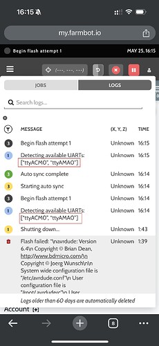

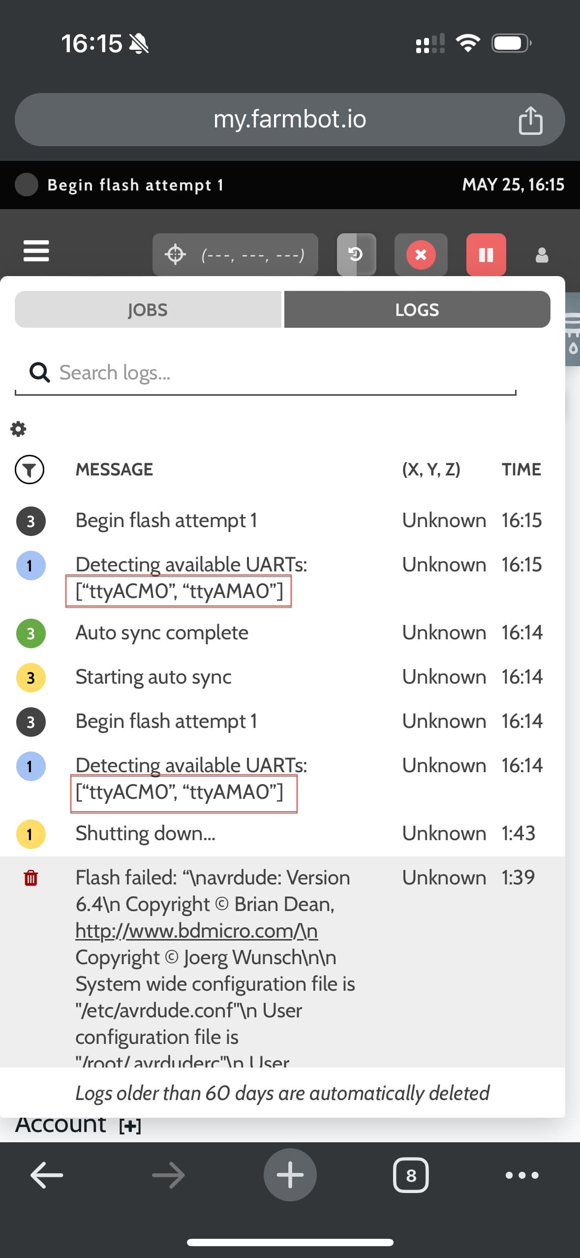

Then after many hours of troubleshooting I decided to unplug the broken camera and switch the USB ports of the data link to another one. And finaly!!! The system was able to recover :slight_smile:
In the logs It was different, I think the UARTs got discovered correctly.
