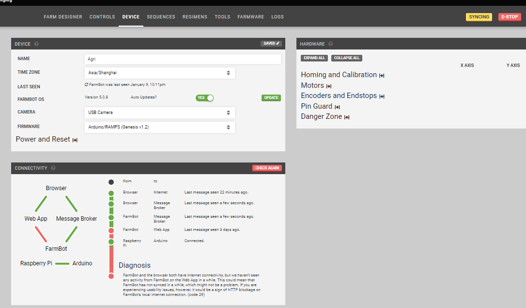

System upgrade to 5.0.8 3 days ago, I clicked update again to 5.0.9 but I dont see upgrade over air in the past 3 days.
Always with below screen… cant connect to machine either.
That’s strange. You would get a log message and the downloading progress in percent if the update got triggered. You could try to reboot the device and try to update again.
If this also does not fix it, you will need to reflash the SDcard using the image and installation guide on this page.
I would expect a DISCONNECTED button instead of SYNCING if its completely disconnected. If you refresh the connectivity diagnosis by pressing CHECK AGAIN, does anything change? Also try refreshing the page and logoff/login from the webpage.
