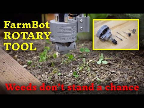

Mow All Weeds featured sequence
We’ve published a new featured sequence called Mow All Weeds that uses the FarmBot Genesis v1.6+ Rotary Tool with the weed whacking implement to perform powered weeding on all weeds in the garden.
It uses the load sensing capabilities of the Farmduino to monitor if the Rotary Tool motor goes over the max load threshold as set in custom settings. If the max load is exceeded, FarmBot will halt its movements, turn off the Rotary Tool, return to the staging position, and try again. The total number of attempts is configurable in custom settings as well.
This new sequence uses all of the latest hardware and software we’ve developed over the last year and is a culmination of what our technology stack is capable of. Let us know what you think!
And if you’re unfamiliar with the Rotary Tool, check out this video:
