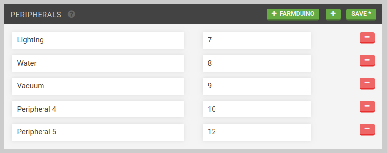

Controls:
- Added a button to add all default Farmduino peripherals.
