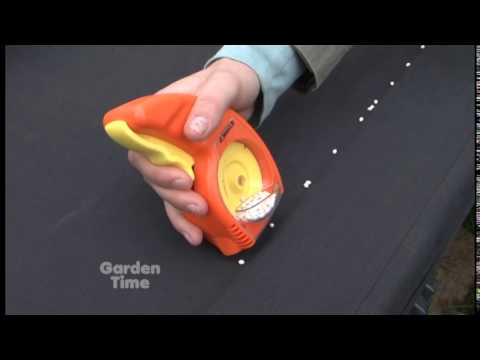

@jpigg55 We are developing a seed drill seeder tool for the FarmBot. Although it is not currently on the top development priority list right at this moment, it will be similar to the Sow EZ tool. This tool will mount on our UTM tool and it will be similar to this tool by the Sow EZ seeder tool company.

It is a neat idea very similar concept to the old plate planters of my youth. While fairly effective, they had issues like the need for multiple plates required depending on seed type, shape, size, and weight along with desired seed population.
While the SowEz attempts to forego with multiple plates by incorporating multiple hole sizes into a single plate that oscillates vs rotates, it will suffer from some of the same issues. Not a problem for an individual since they would detect these failures at the moment, but not so on a platform like FarmBot without some sort of detection system.
The concept I had in mind is closer in operation to a combination of early air planters and grain drills. I’m still trying to work out the details, but those planting systems were a lot more versatile than the current system or the SowEz in the variety of seeds it could handle.
It is a hand held seed drill as you say. It just reminded me of downfall
