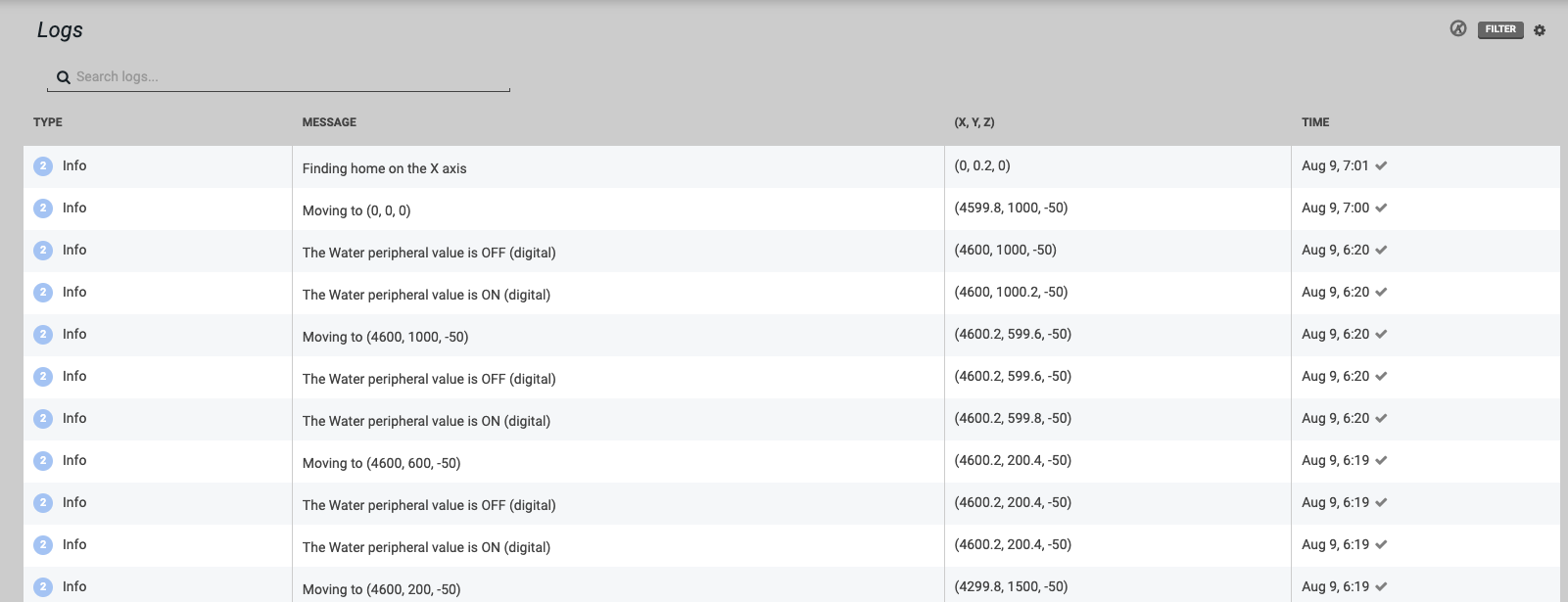

Since a couple of days, I’m getting an error on my Go Home Sequence
Any ideas to what might be wrong and how to fix this?
Thanks in advance.

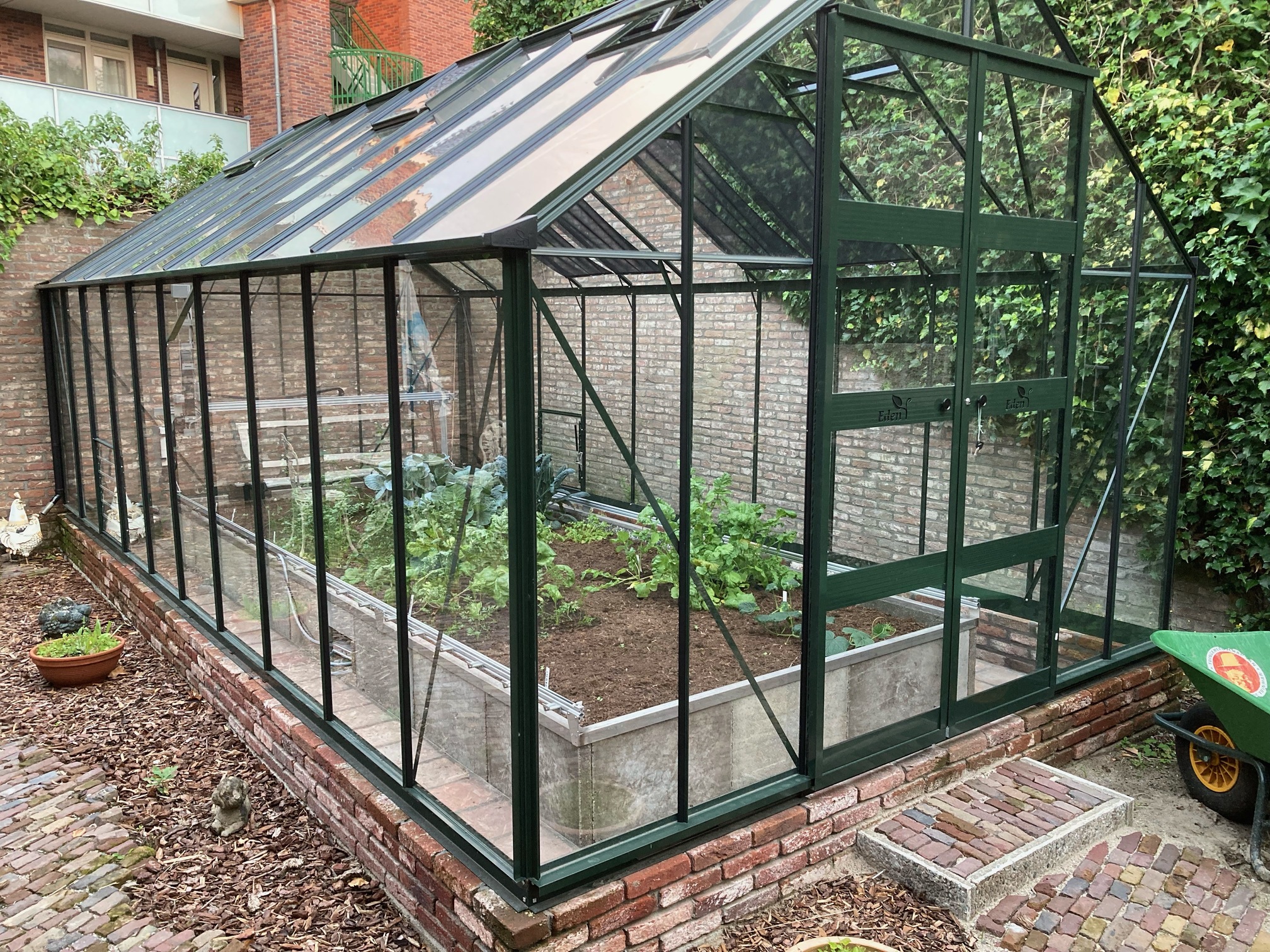

@RickCarlino thanks very much. I’ll let you know if I’ve got any more errors in the morning. And yes, you remember correnctly
Sounds good @Dick ! Very nice photo. I’ve only seen photos from inside the greenhouse previously so it is nice to get the outside view also. I am going to share this photo with the team.
