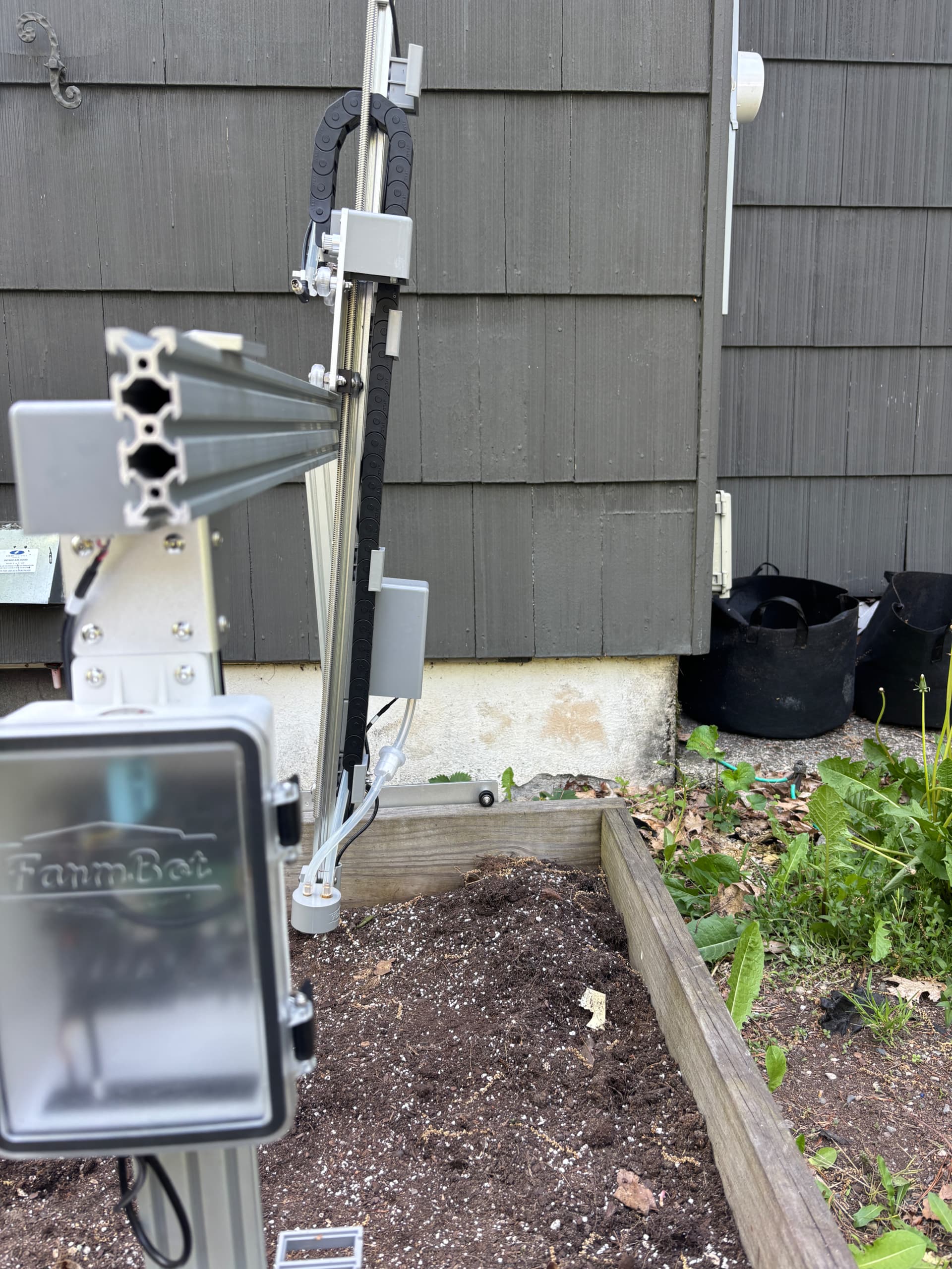

Question: Weaving it all together now. The Z assembly seems to roll fine. it tilts though and not seeing how it gets leveled or tightened up. Seems it is because of the weight imbalance of all the gear on it.

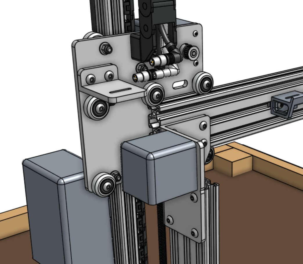

The Cross-Slide/Z-Axis assembly should be sitting a little bit lower such that the V-wheels are running on both the top and bottom of the gantry main beam.
Please take a close look at this step of the assembly process: Attach the Z-Axis | FarmBot Express Documentation
