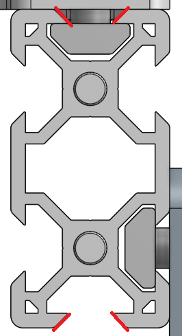

2.When you are setting up your tracks, please ensure that the diagonal surfaces do not have any bumps, gaps, or misalignment. You may need to take some sand paper to sand away any discontinuity in the track surface. When you touch the interface between the two tracks, the surface should feel perfectly smooth as if it were a single track.
The surfaces that I am talking about are marked in red [See Graphic Below]. These are the only surfaces that make contact with the diagonal surfaces on the wheels. These surfaces need to feel smooth to the touch where the sections of track join together.
