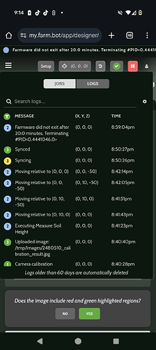

Bumping here for assistance. Never displays an error just does not complete the height calibration test.

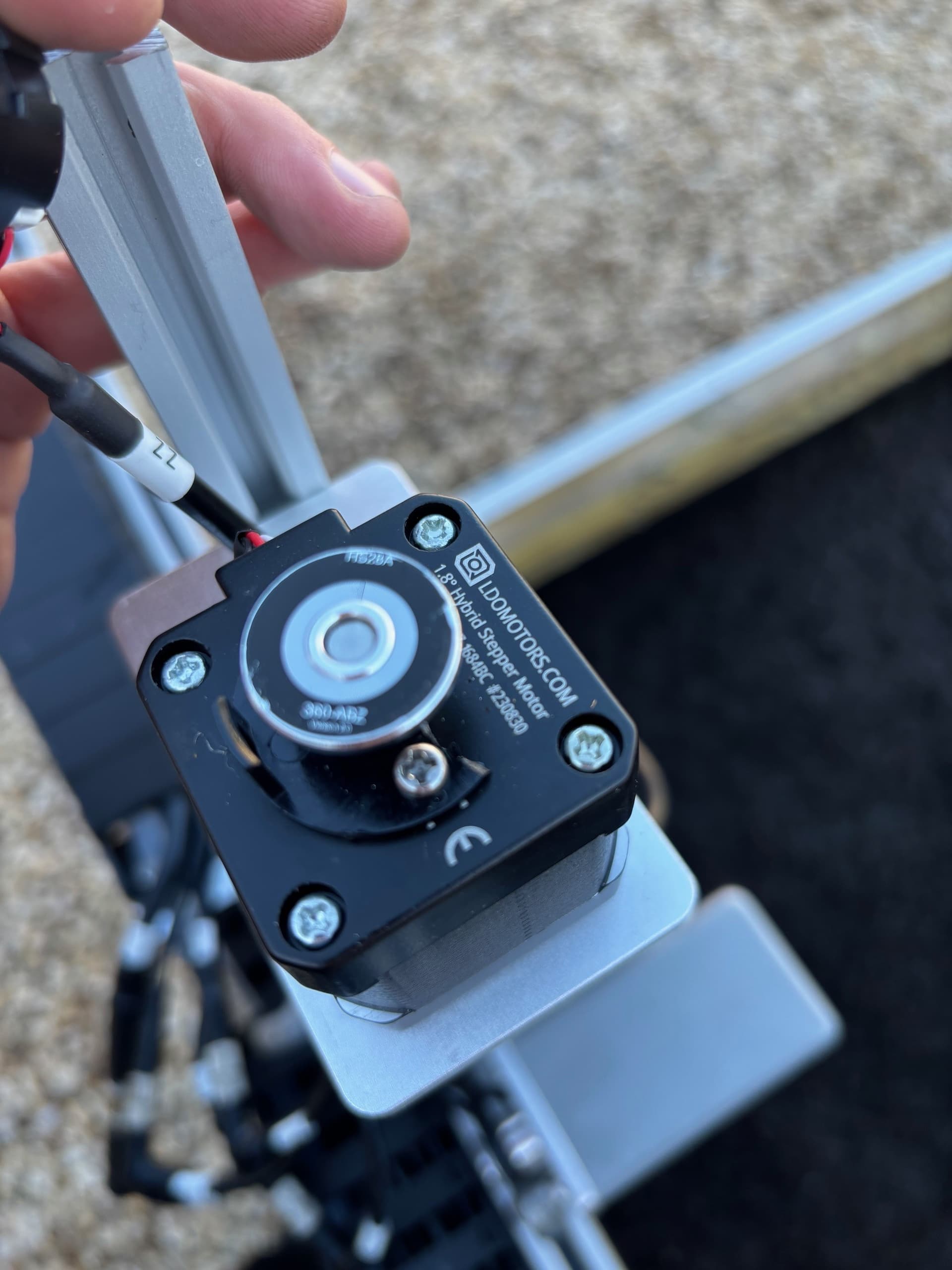

I don’t think anyone will be able to remote into the farmbot itself for you but I would definitely check the z encoder at the top of the axis in the grey casing. I opened it and the top of the motor was broken, as (hopefully) pictured below. If the cable feels very loose that will indicate that.
That circular bit should have a plastic cover over it
You would be able to detect a broken Z-axis encoder while moving, I honestly think that is must be something else.

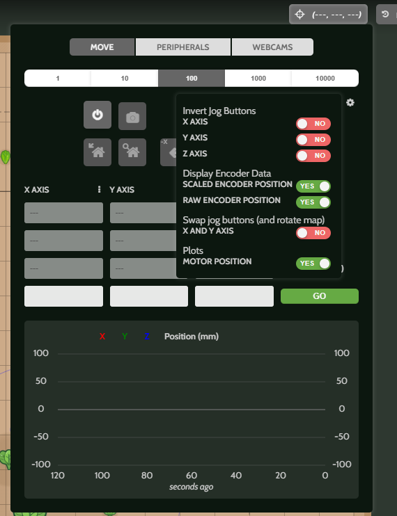

But you can monitor your encoder values in the controls card, there is a guide that should still work even if it looks a bit different:

Can you send a video or some photos of the height detection calibration so we can see exactly what is happening?
