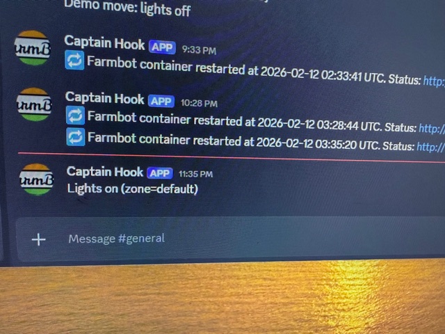

  • all have Discord updates on a specific server channel

Discord notifications for all actions
Every action now posts a Discord message using a webhook stored in secrets.
  • This gives you a live “action log” on Discord.
  • Messages are short and readable, not raw JSON.

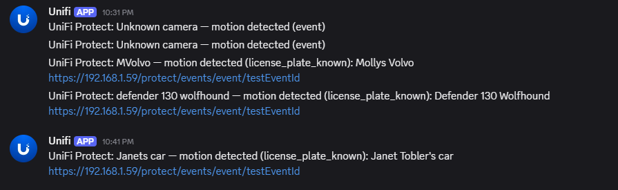

ok, so this is just me for other Unifi events as Discord posts should be formatted as readable text, not raw event dumps that Unifi provides. Its already solved with the farmbot webhooks so I had the container available to use the same process pass through for alarms/alerts for license plate reading.
Added /webhooks/unifi-protect-discord:
  • Accepts UniFi Protect webhook JSON
  • Formats a Discord message (camera/alarm name, trigger type, event link)
  • Posts to Discord via a webhook secret (discord_unifi.txt)
  • UniFi payload dump tool
Added /webhooks/unifi-protect-dump:
  • Logs full raw JSON payload and headers to container logs
  • Used to reverse‑engineer event formats for custom Discord messages
