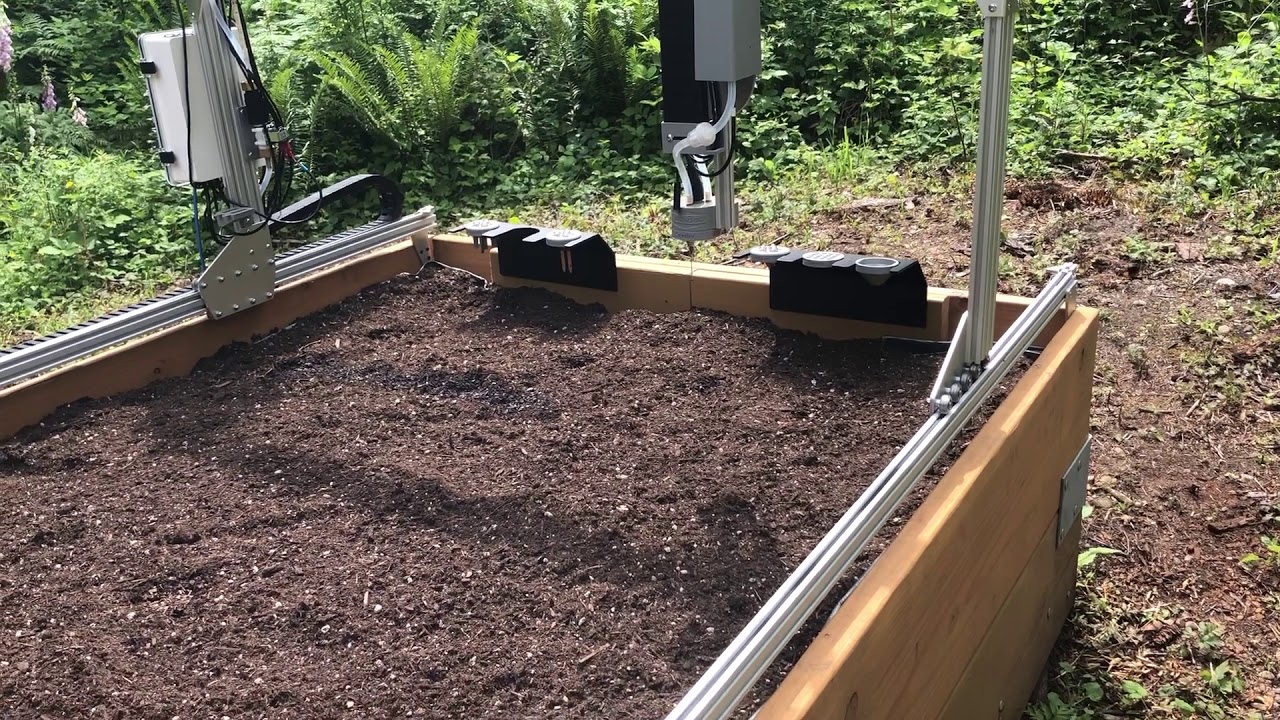

I ended up using wood. When assembling I thought “oh no, I should have used some artificial material because wood is never straight.” But I didn’t actually have any issues with it. One thing that I did do that think helped me (because I’m very poor with wood and made lots of mistakes) is using heavy duty brackets to pull by wood in to be square.
FWIW, I did not end up using the dowels that hold the two side pieces of track together. The documentation indicated they were optional and it seemed like more risk of damage.
You can see my system in operation if you like. This was from last year when I first got it set up.
