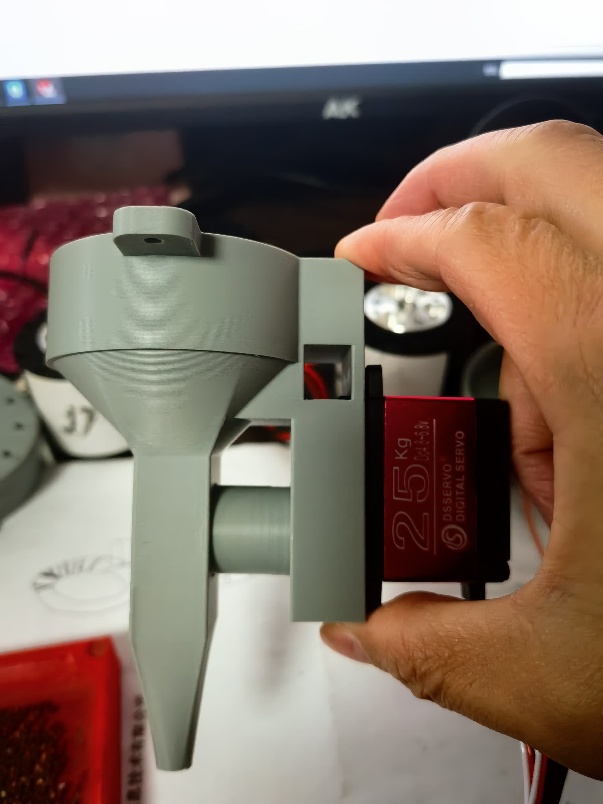

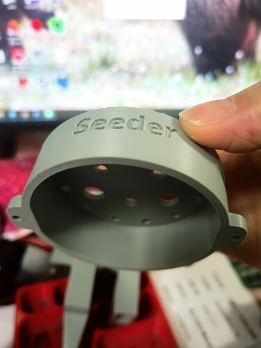

I tried using the version you provided, but there were some issues with the model printing. Based on how it works, I redesigned a simpler version myself.

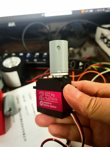

Based on the different seeds, I can design different rotating shafts and adjust the size and depth of the grooves accordingly.

No problem. I’ll release the model after I’ve perfected it and done some testing. It’s not running with Farmbot yet. I’m only controlling it via ESP32 to test if the seeder is working.
However, there are some additional issues that need to be addressed:
  1. This rotation method easily crushes the seeds.
  2. It can’t yet accurately sow only one seed at a time.
  3. Fixing the tool head.
  4. 12V power supply for the tool head.
  5. The ability to control sowing through the Farmbot mechanism and integrate it with the sequence.
This likely requires developing a separate tool head for digging holes and a burying tool head. The digging and burying tool heads could also be replaced with different connectors on the rotating tool head.
Alternatively, watering could be used to cover the seeds with soil.
The complete sowing process could be achieved by first using the digging tool head to dig holes and position them, then using the seeder to sow the seeds, and finally using the burying tool to cover the soil.
After testing, the current version can correctly handle seed planting:
  1. Seeds are placed at a 15-degree angle. The lower seed placement is at approximately 150 degrees, solving the problem of seeds being easily crushed.
  2. The tool head’s fixation has been improved; the seeding part is now secured with screws for greater stability.
  3. The seed opening on the rotating shaft has an oval shape, adjustable for different seed types, making seed loading easier.

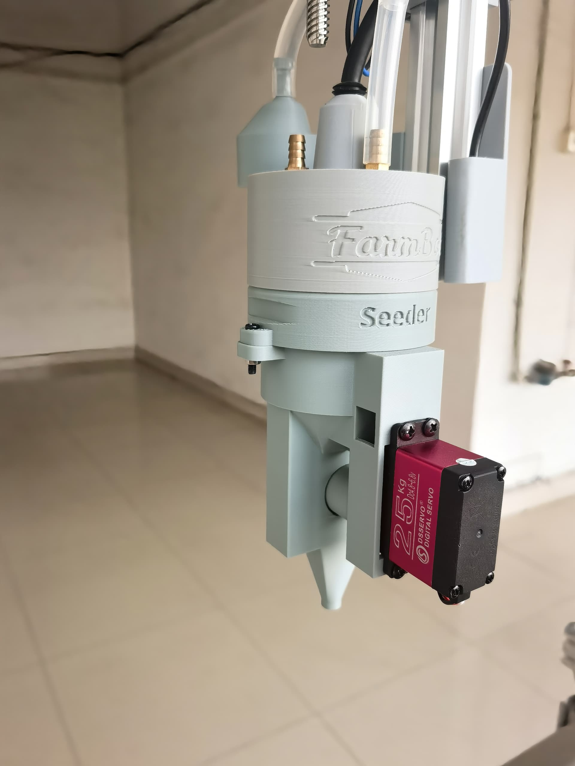

The newly designed seeding tool has been tested for over an hour of continuous operation. The problem of crushing seeds has been significantly reduced. The previous design had a noticeable cross-cutting issue, but by placing the seeds on one side, the situation has greatly improved.
I will test different seeds later when I have time to see how they perform. My priority now is to integrate it with FarmBot and use it in our experimental field to see the results.
I will provide updates on any further improvements here.
It can be controlled and run normally.
I connected the G pin of the general-purpose tool head directly to port D4. Currently, pins A=5V, B-C=GND, and G=D4. This allows for sequential control of the servo motor, with pin 4 selected for control.
In principle, pins 4, 5, 6, and 11 can all be used, as long as they are connected to different pins. These pins are all servo control pins.
Farmbot has done a very good job of making expansion extremely easy.
