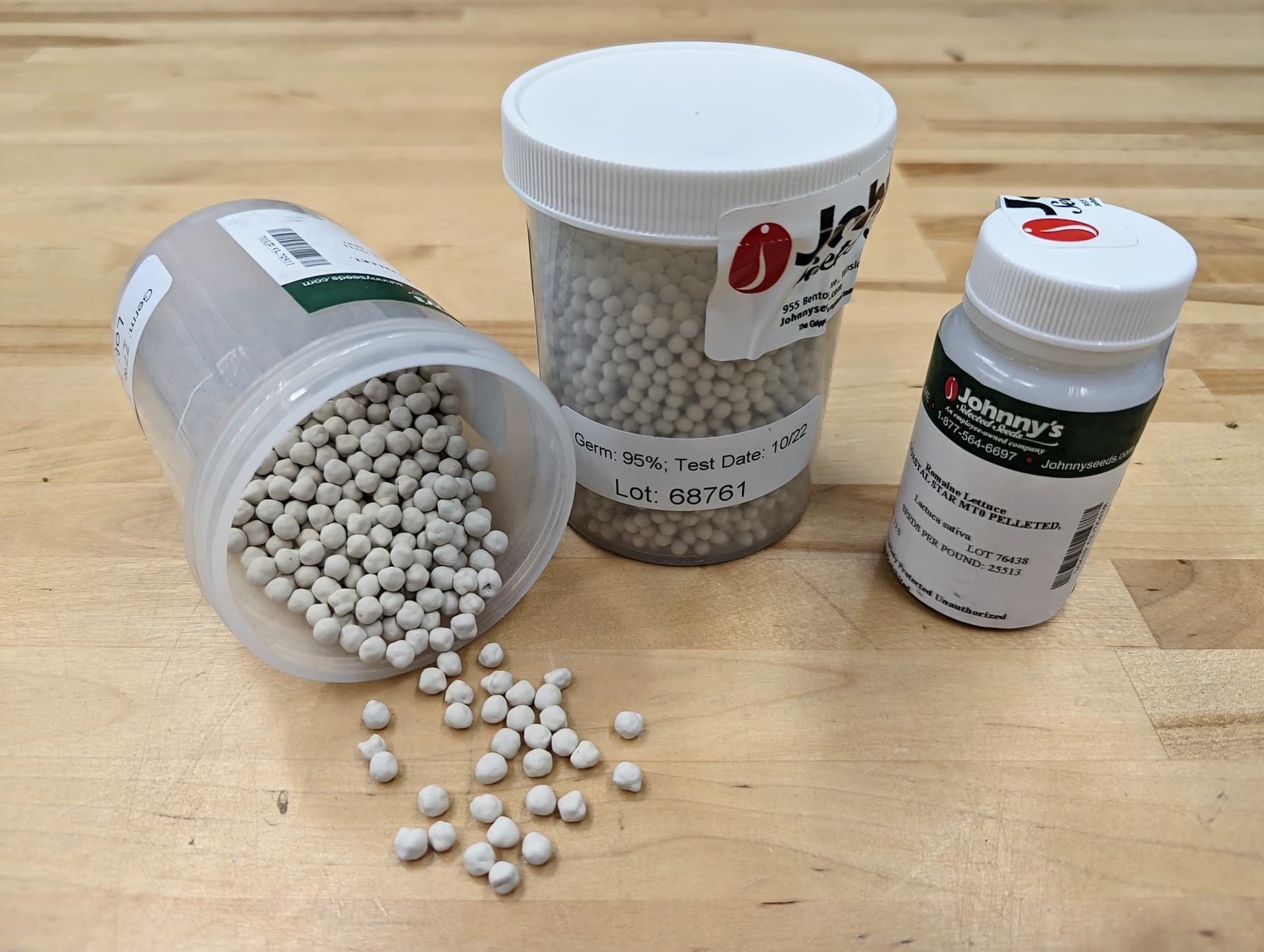

Unfortunately, some types of seeds work better than others with the seeder tool. For the best results we suggest using pelleted seeds because they are perfectly spherical and they fit onto the tip of the luer lock needle.
In some instances, it may be more practical just to plant the seed by hand and use the FarmBot seeder tool to mark the exact location co-ordinates (X,Y, Z) of the seeds.
