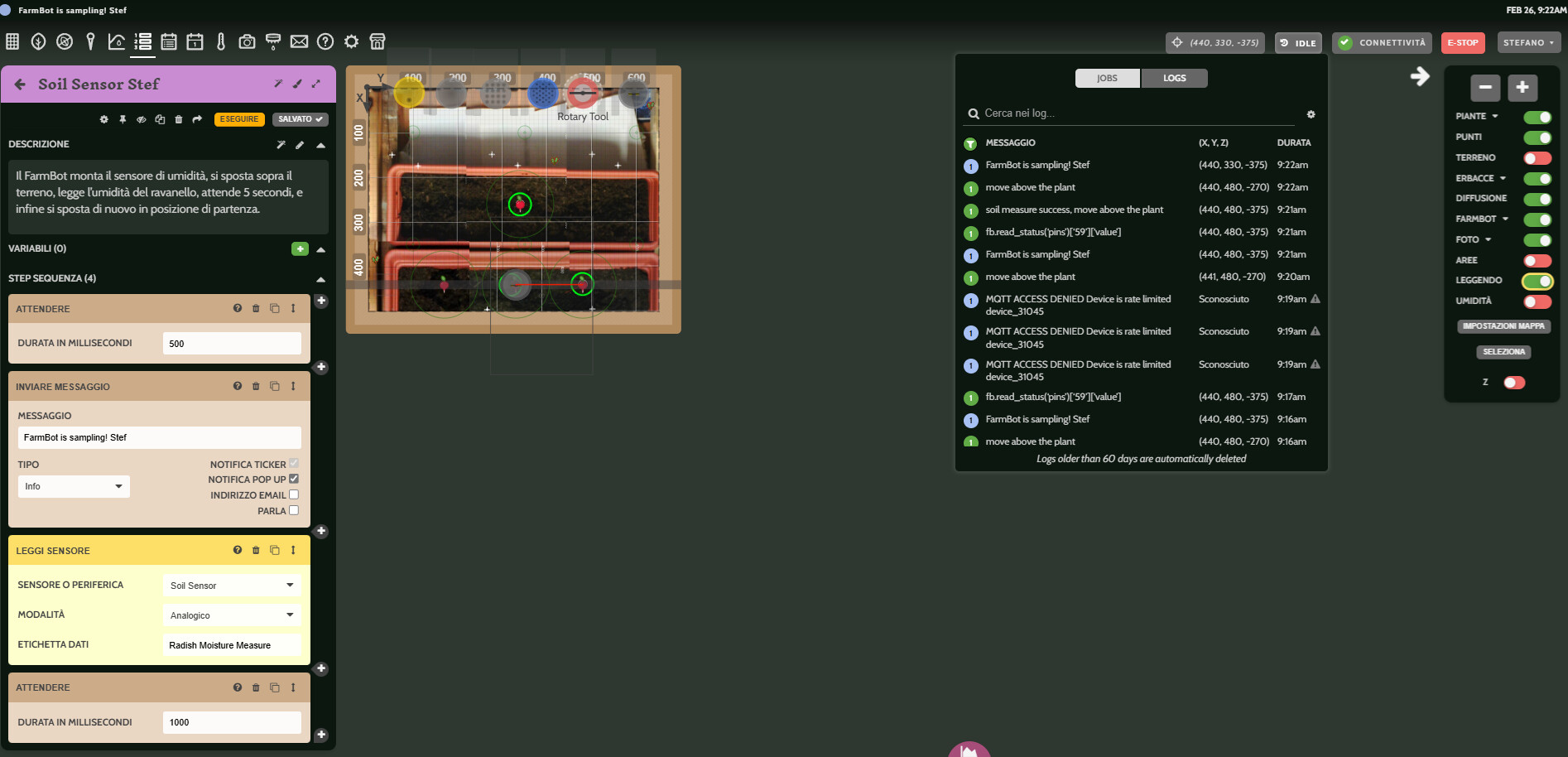

I wanted to share an update on the code I am working on. It reads all the plant points and then samples the soil moisture one by one. To do this, I move the robot arm using Python code. I have also attached the implemented sequence; it’s quite simple.
To get the position, I decided to use local_position = fb.read_status(“location_data.position”), as it is the most stable method. The fb.move command is working well.
However, the soil sampling (see def playSequence(sequenceType, fb, plant)) works perfectly the first time but crashes during the second attempt. Specifically, the second time the program executes the sampling command soilSensor_value = fb.read_status(‘pins’)[‘59’][‘value’], it fails.
It’s worth mentioning that when I use debugging mode and manually launch the sampling command twice, it works on the second attempt.
I suspect that the issue is related to MQTT, and I am unsure if it can be resolved. Perhaps I need to introduce a delay or a different approach.
I believe that CeleryScript is not necessary at this stage. Do you agree? Otherwise, I am open to studying it further.
If you are interested, I can keep you updated and share my code for further review.
My ultimate goal is to integrate this code into ROS2.

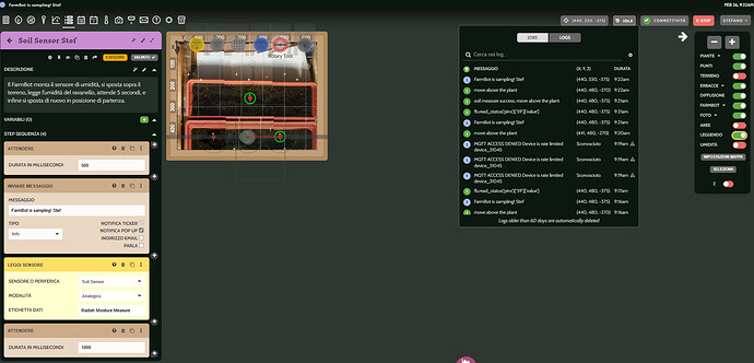

Hi @leonori that’s a perceptive comment and we can make things work correctly.
Did you notice those 3 log messages at 9:19am on the Web App
MQTT ACCESS DENIED Device is rate limited
They’ll be causing your code to crash because your code always assumes valid results from fb.
I’ll need more time to find a solution in your code . . .

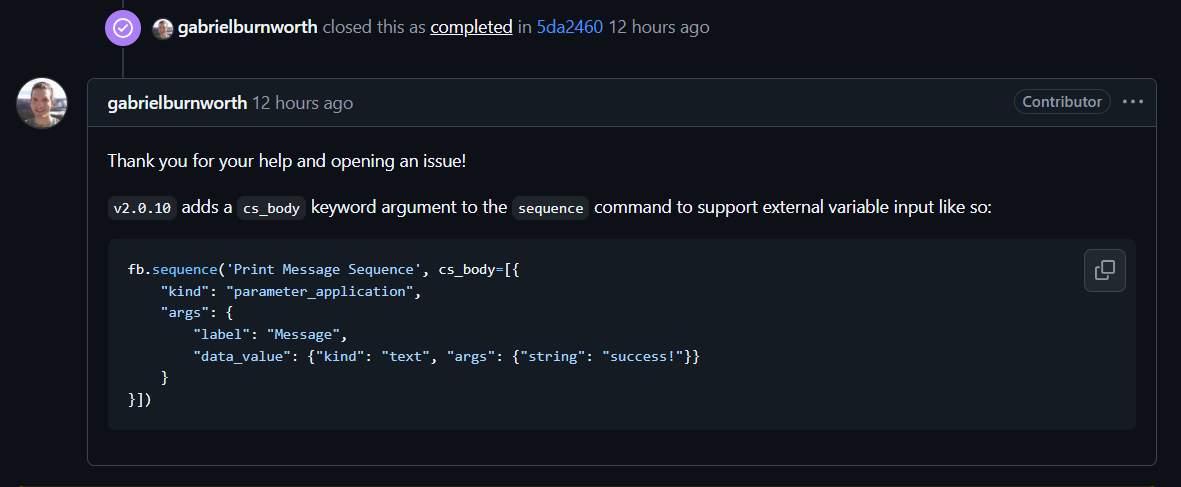

Seems FarmBot Python library v2.0.10 has a change which allows this :slight_smile:

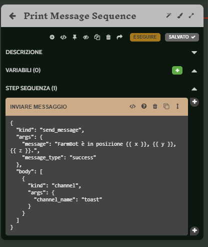

Hi, I updated the library and ran the script below, but it’s not working. I don’t understand what kind of error I made. Could you help me figure it out?
The program does not crash but no toast message is published.
fb.sequence(‘Print Message Sequence’,cs_body=(
“kind”: “send_message”,
“args”: {
“message_type”: “success”,
“message”: “FarmBot è in posizione {{ x }}, {{ y }}, {{ z }}.”
“body”: [
“kind”: “channel”,
“args”: {
“channel_name”: “toast”
Immagine 2025-02-27 102119

If you’d like to send CeleryScript that you write yourself you can use the publish command, but in most cases there’s a FarmBot Python library function using terminology similar to what you’d see in the FarmBot Web App that you can use instead (like the toast function).
Regarding the Python code you shared, fb.sequence('Print Message Sequence') will run the Sequence named “Print Message Sequence” that you have in the FarmBot Web App, which according to your screenshot already has the Send Message step, so any additional arguments are erroneous.
The change in the library with v2.0.10 allows adding variables when running a Sequence using the sequence function. Adding values of variables while running a Sequence from Python was previously only available using the publish function. The Python part of using it is shown in the screenshot @jsimmonds shared, and the Sequence named “Print Message Sequence” in the FarmBot Web App that it runs would have an externally defined text variable labeled “Text” and a Lua step that does something with the value of the text variable.
If you’d like to input an externally defined position, you can use the following Python code which supplies the value of a location variable to the Sequence run:
fb.sequence("My Sequence", cs_body=[
      "kind": "parameter_application",
      "args": {
        "label": "My Location",
        "data_value": {
          "kind": "coordinate",
          "args": {
            "z": 3,
            "y": 2,
            "x": 1
The Sequence named “My Sequence” in the FarmBot Web App would have an externally defined location variable labeled “My Location” and Sequence steps that do something with that location (possibly a Lua step).
