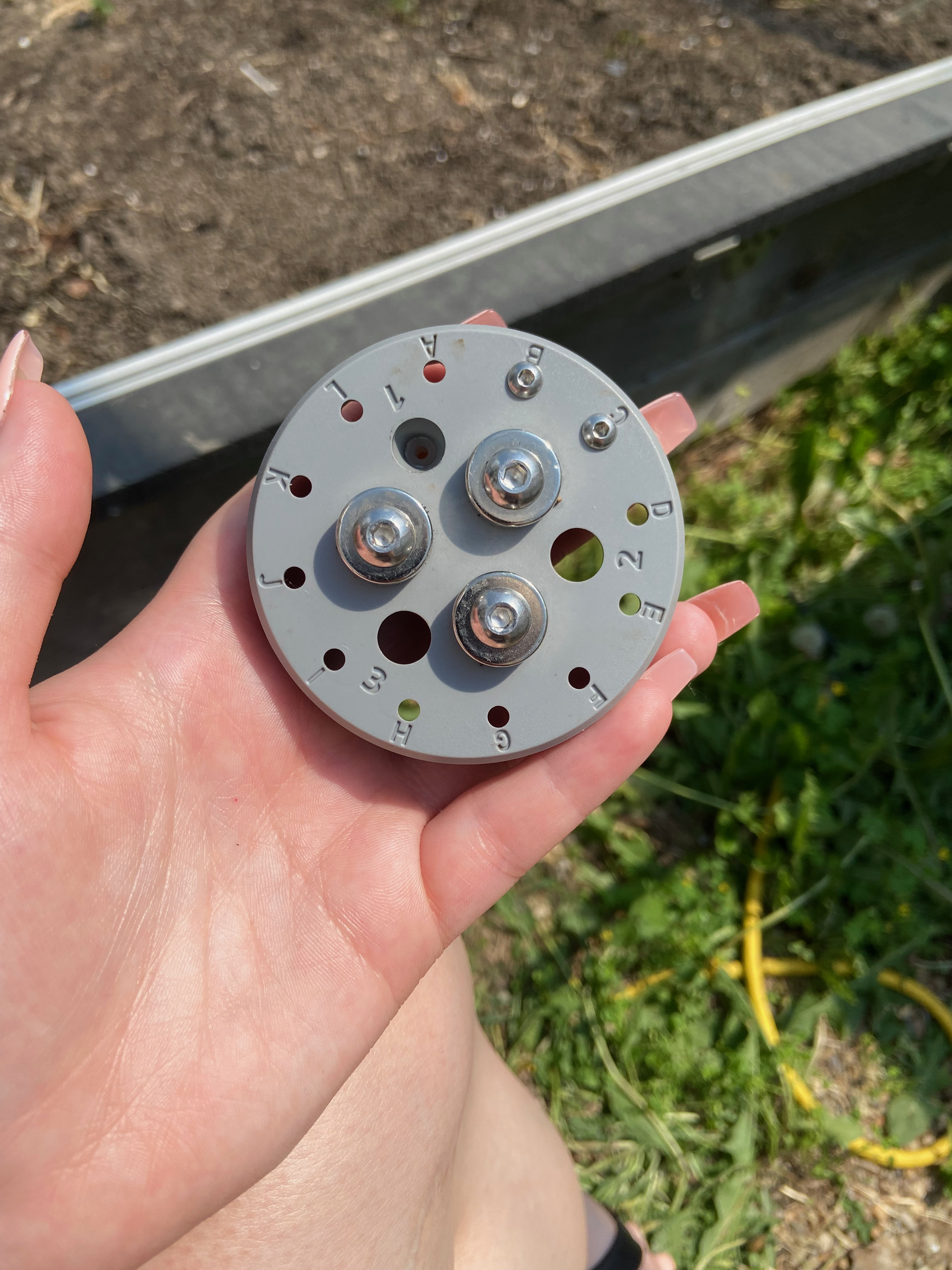

@aburbick can you provide a photo of the underside of your UTM as well as the top of the Seeder tool?

@roryaronson here is the picture of the underside of the UTM!
FYI, the white stuff is our attempt at using plumber’s tape.
@aburbick - Oh, you’re missing the black washers. They go on the grey stubs you tried to use Teflon tape on. You can order replacements here: Amazon.com
You can see them installed in the pic of the UTM on the FarmBot store:
@aburbick I think @stre1026 's assessment is spot on. Is it possible you missed that step during setup? Were the gaskets missing from your kit (if so, we can send you a replacement)? Please let us know if you require further assistance.
@aburbick, @stre1026 is correct. The UTM should have come with three black rubber O-rings pre-installed where you put the white plumber’s tape. The O-rings create a seal between the top of the Seeder tool and the UTM. Without the O-rings, air will get sucked in through a small gap and prevent a seed from being held onto the needle.
