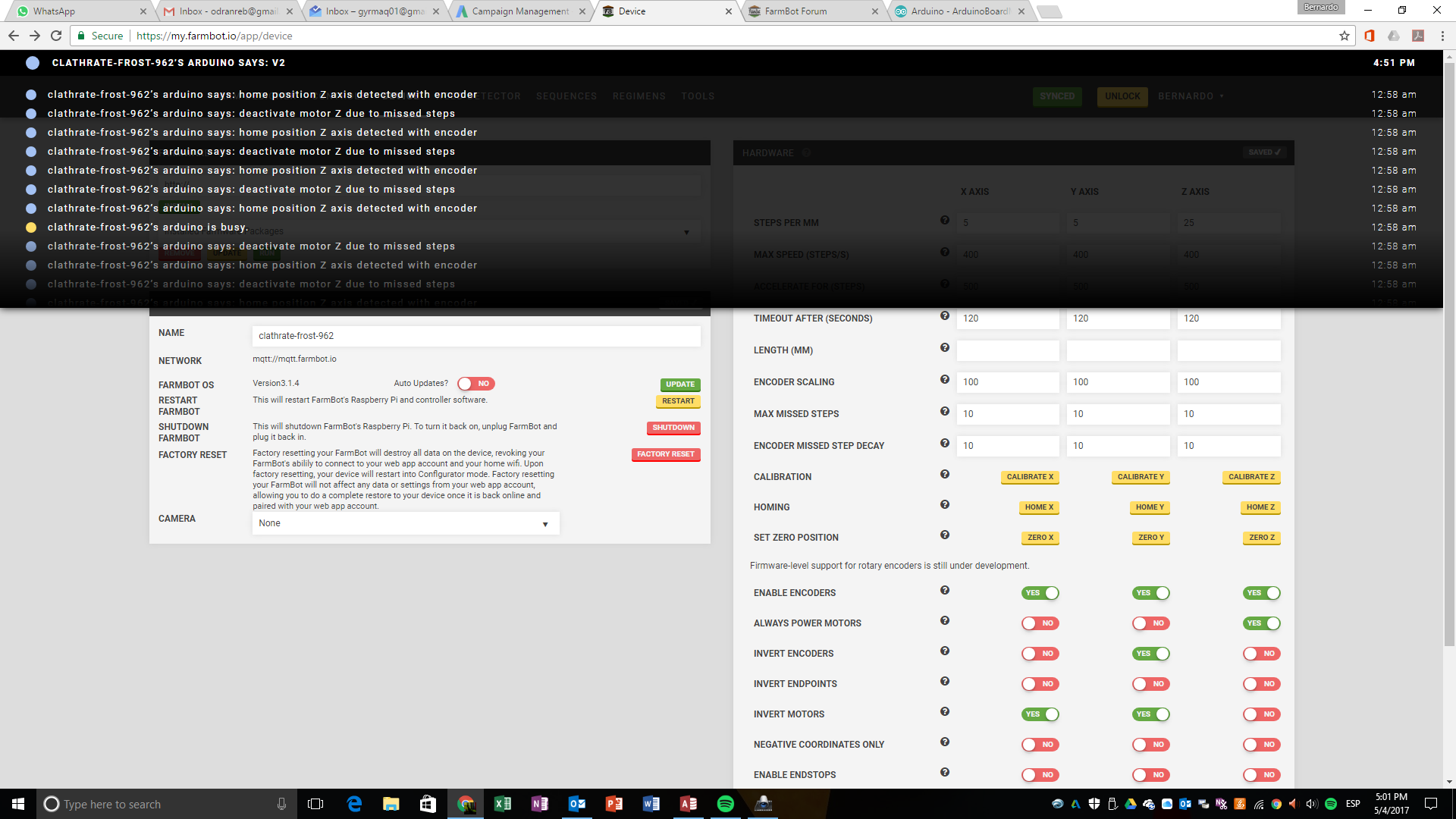

here is the device page print screen when it stops with “movement complete” and no further errors it only stoped

The screenshot shown (of the logs) is from 5/4/2017, do you have a newer one?

Nice video, and thanks for reporting the issue! We have fixed a bug and uploaded a new v5.0.1 release. You can upgrade your device and the issue should be fixed.
It works fine! thank you!
