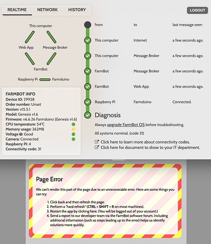

When loading the events [The FarmBot Web App] i get the “Page Error” notice in Red and yellow.
I’ve flushed the cache, restarted the browser and the farmbot, even changed the browser.
I can connect to the FarmBot, move the heads even create new sequences.. but I can not access the events.
Any advice?
Seems you’ll need FarmBot Support email for this but I’m curious : do you expect to see any scheduled events on that page (or none) ?
Thank you for bringing this to our attention! It looks like your account had some bad data which was preventing the page from loading. We’ve cleared the offending events from the backend so the page should load successfully again now.
We’ve also updated the Web App to prevent the issue from happening again.
