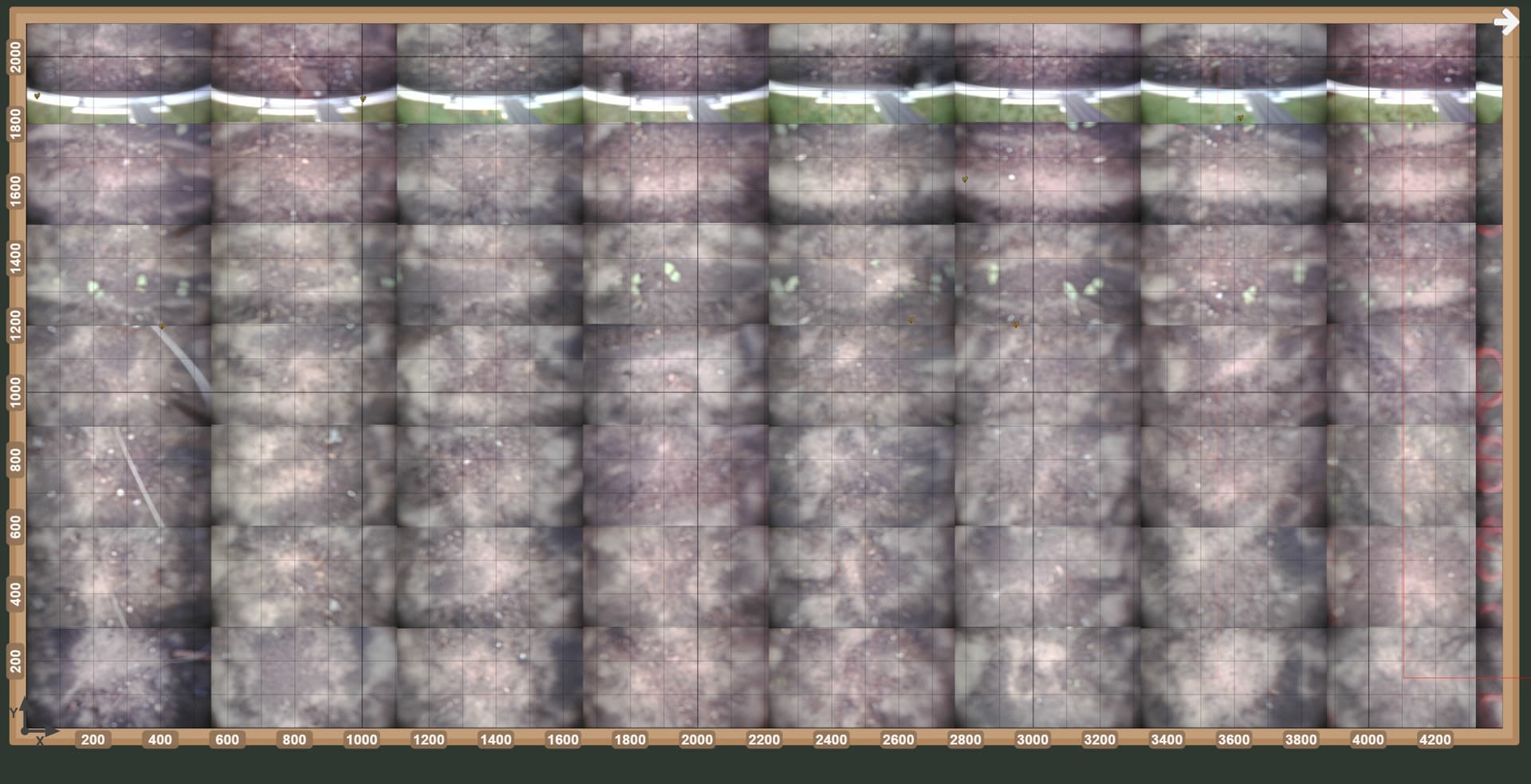

Hello I seem to be getting an issue with my camera taking the top edge of the garden bed and displaying it upside down for some reason.
any thoughts?
any thoughts?
Hi,
You could try to check the camera rotation setting. What value do you have there?
Usually, it should be as near as possible set to 0. If not, then you might have to rotate the camera manually.
Camera rotation in degrees. This value should be minimized (to near zero) by rotating the camera in its mount until it is aligned with FarmBot’s axes. (default: 0)
The pictures look very blurry. Did you have had moisture on the lens?
after taking more photos i think youre right, Im going to adjust the camera manually, seems like i have it upside down
