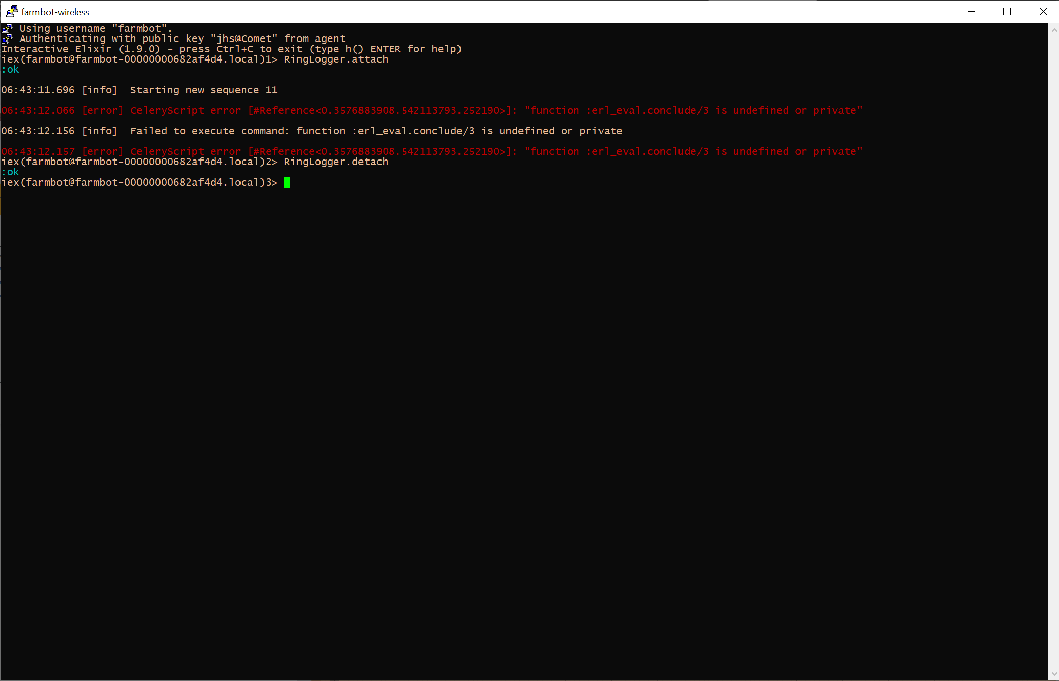

Seems the current Web App API ( or FBJS ? ) allows ill-formed Control Peripheral
blocks to be created.
Created one Sequence with this single block :
"kind": "write_pin",
"args": {
"pin_value": 0,
"pin_mode": 0,
"pin_number": {
"kind": "named_pin",
"args": {
"pin_type": "Peripheral",
"pin_id": 5433
by using the Web App UI Sequence editor Add.
Test RUN results

My apologies. I should post under a different topic for Pre-Release issues !
Matchable conclude/3 is missing in the code.
| final edit
I fixed it like this, but I suspect you’ll have a better solution
@jsimmonds Looks like this one did not make it in to production. As always, I appreciate your help in testing FBOS releases.
@jsimmonds This has been fixed in 84bdddf.
