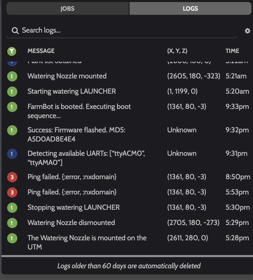

I was attempting to track down a code
in that my scheduled tasks were no longer workings. They would just disappear at the scheduled event. I left it over night then this happened.
Why did the FB reboot?
Yes it fixed the scheduler issue however the evidence of the problem is lost as it now works again.
I think there’s a “recovery” strategy of “REBOOT” when MQTT connectivity has been lost for some period.
The code should tell you.
I was half expecting there to be some detection software, but I think it would be helpful if there are log entries of what FB is up to.
