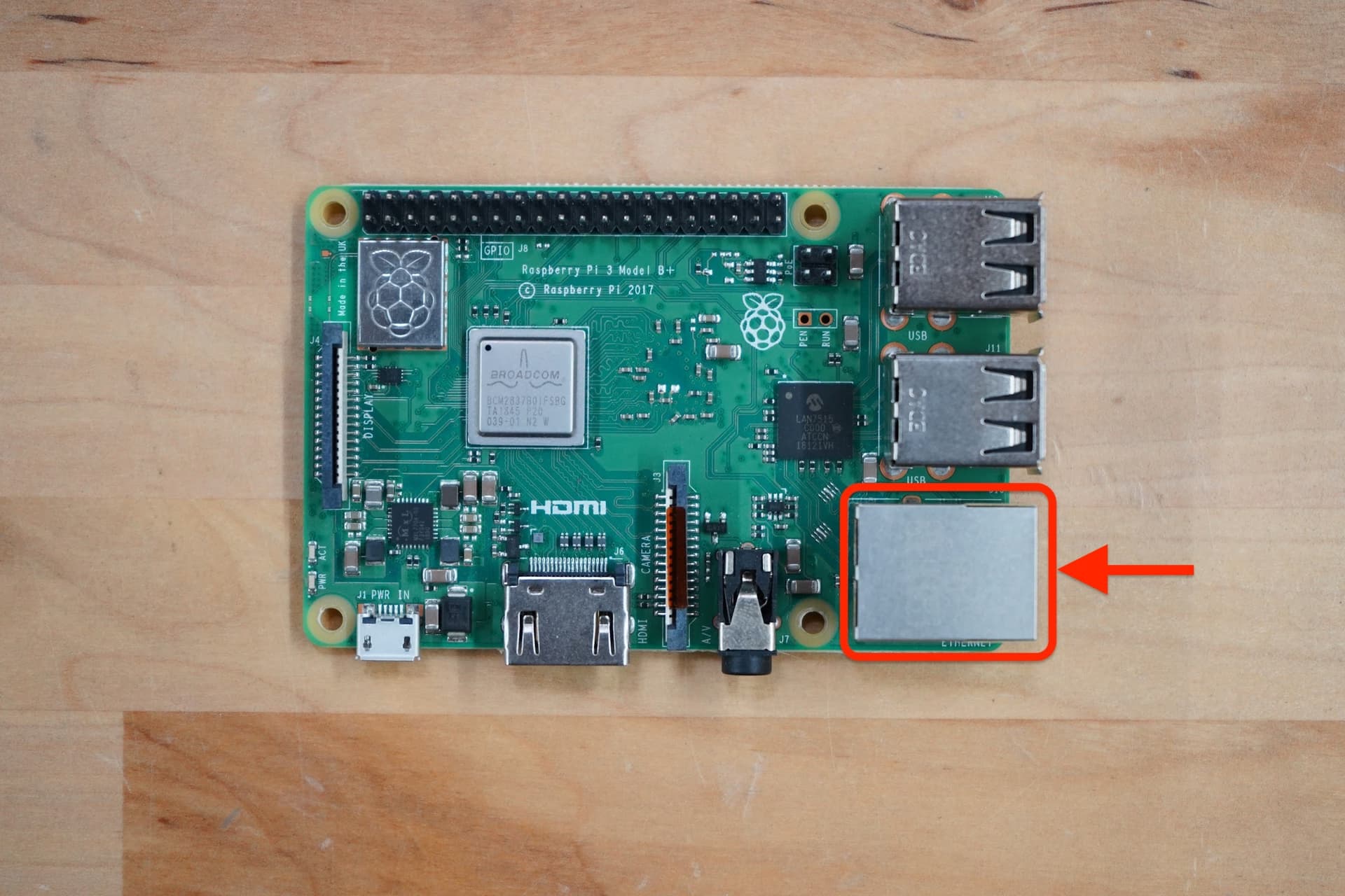

@ncnynl
We have created a troubleshooting document to help you with exactly this issue. If possible you should try to connect to the internet via ethernet cable or improve the Wi-Fi signal strength with a signal booster or Wi-Fi range extender.
Which specific model of FarmBot do you own?
Please review this page:
