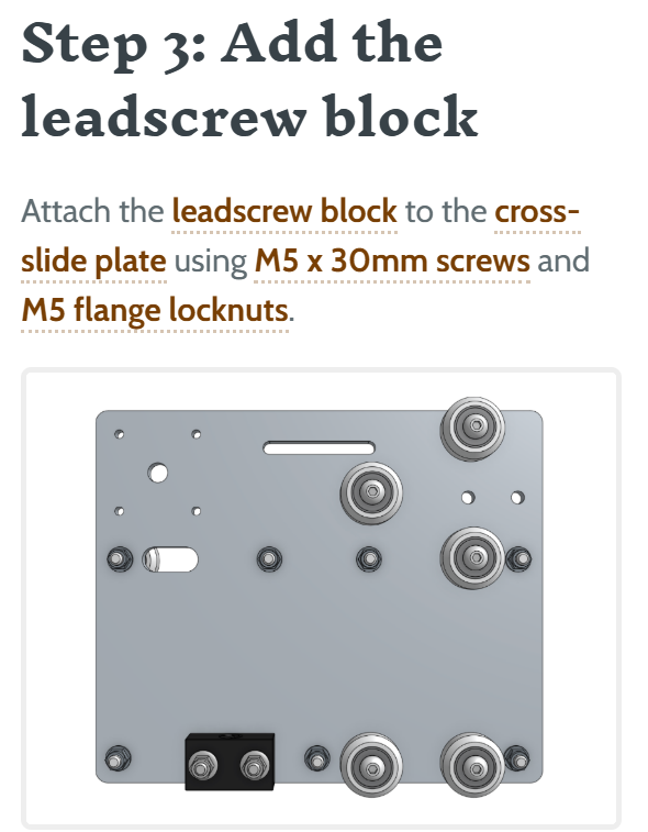

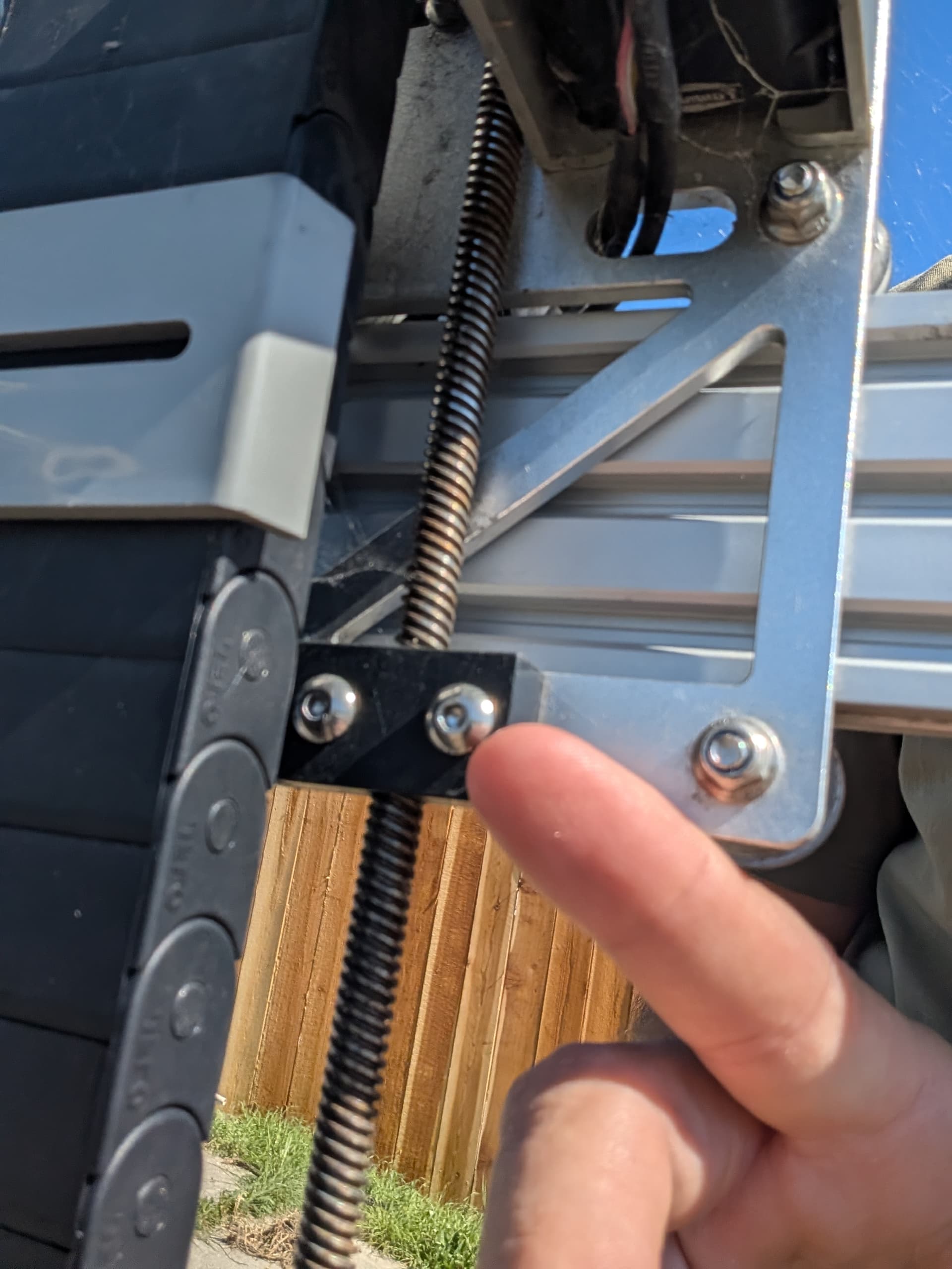

I got back from vacation to find my farmbot was trying to go up or down on the z axis for so long that it drilled out a piece. I need to replace it but I can’t find documentation of what the part is called to search for it. Sure anyone know what this is called?

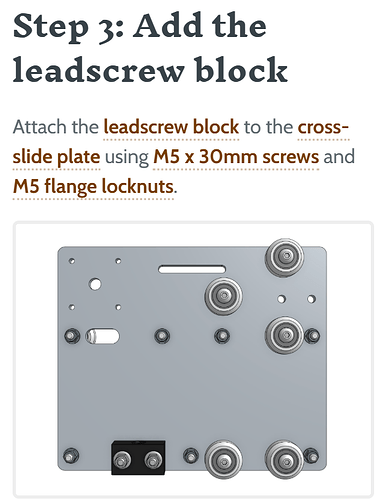

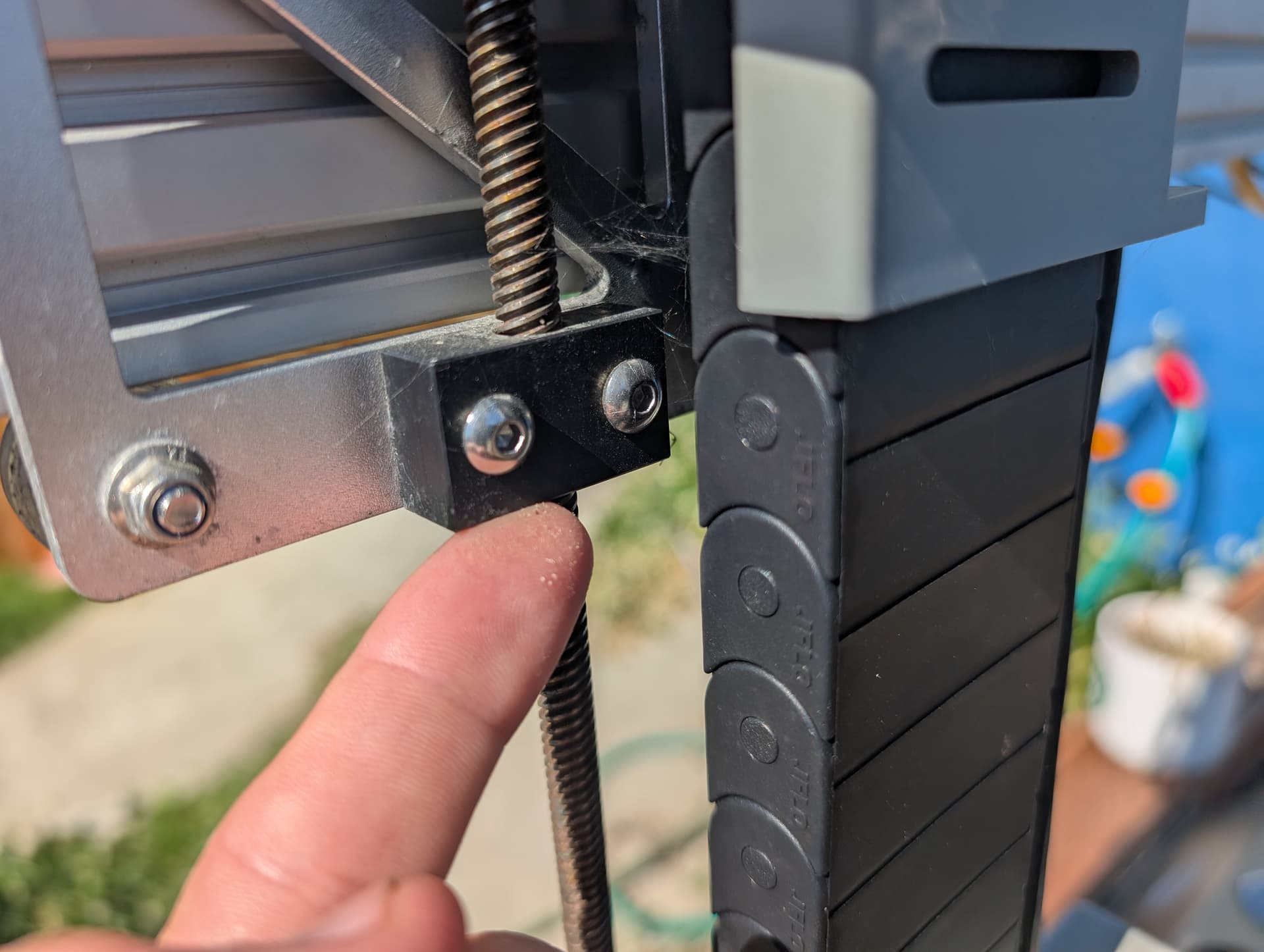

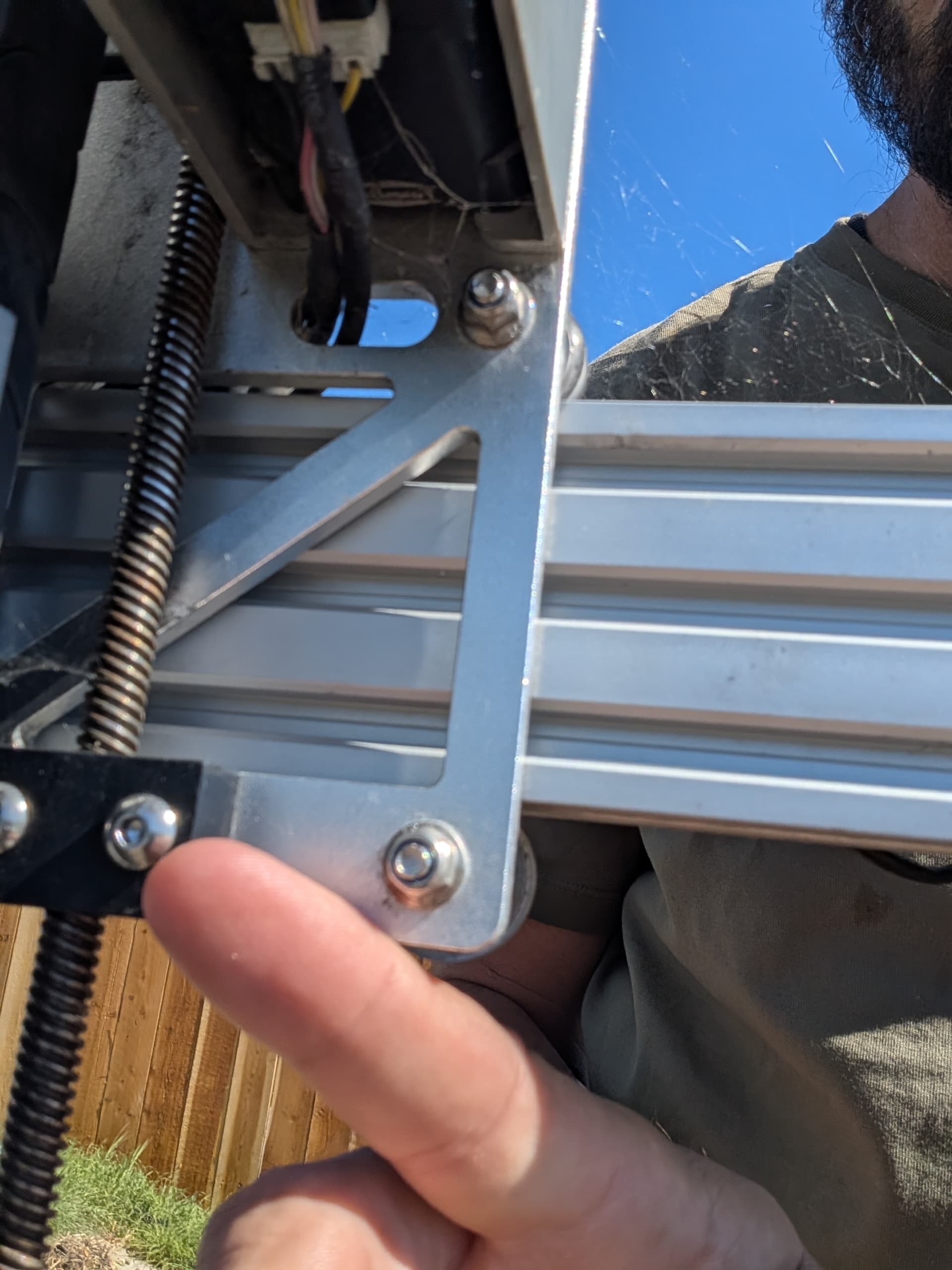

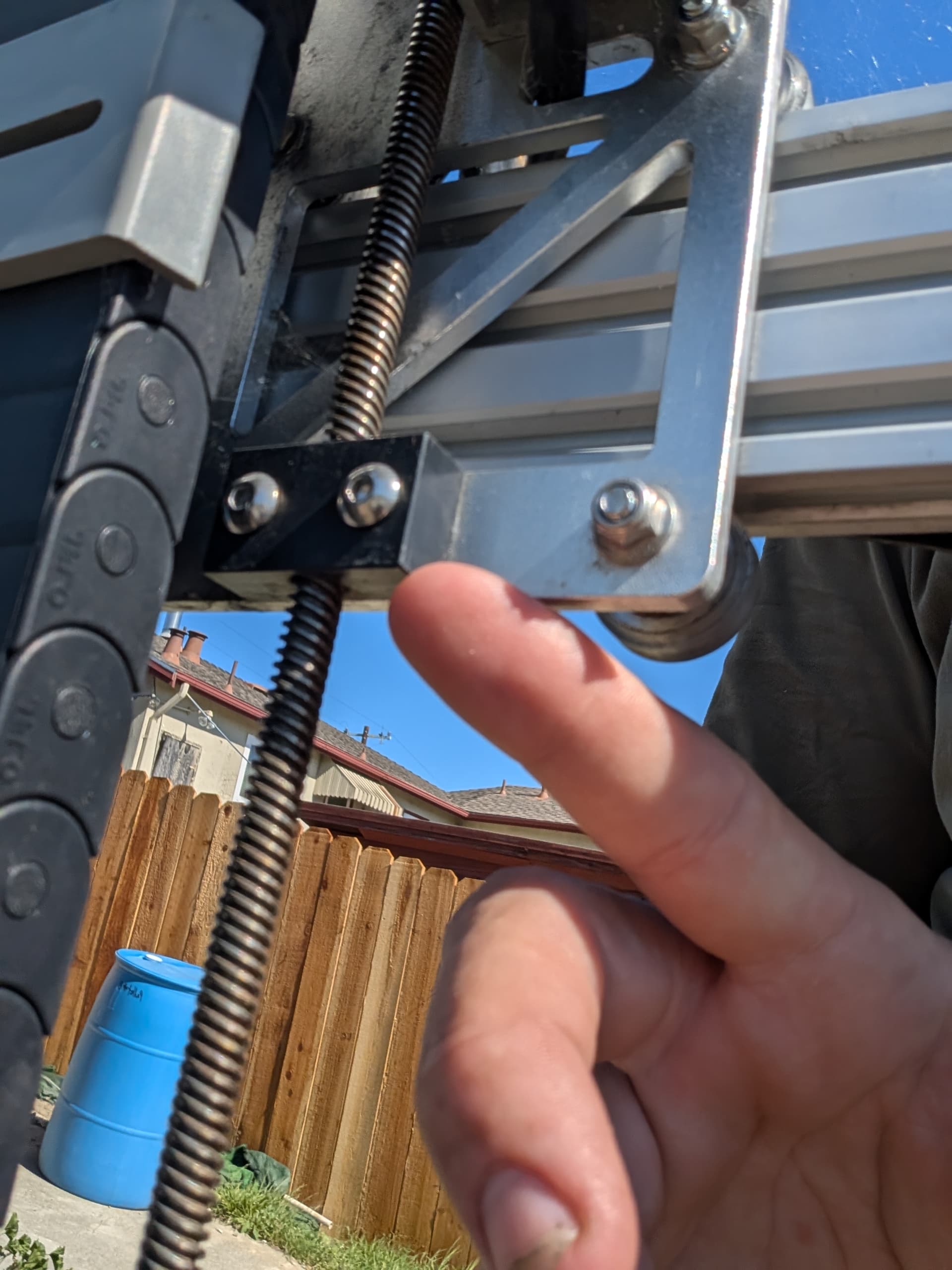

Multiple photos included to make it clear what I am pointing at.
Looks like you mean that Leadscrew block. They seem to be out of stock at farmbot sore, but you should be able to find them on other stores as they are most likely openbuilds standard ones.Try searching for “TR8 ACME block”.
