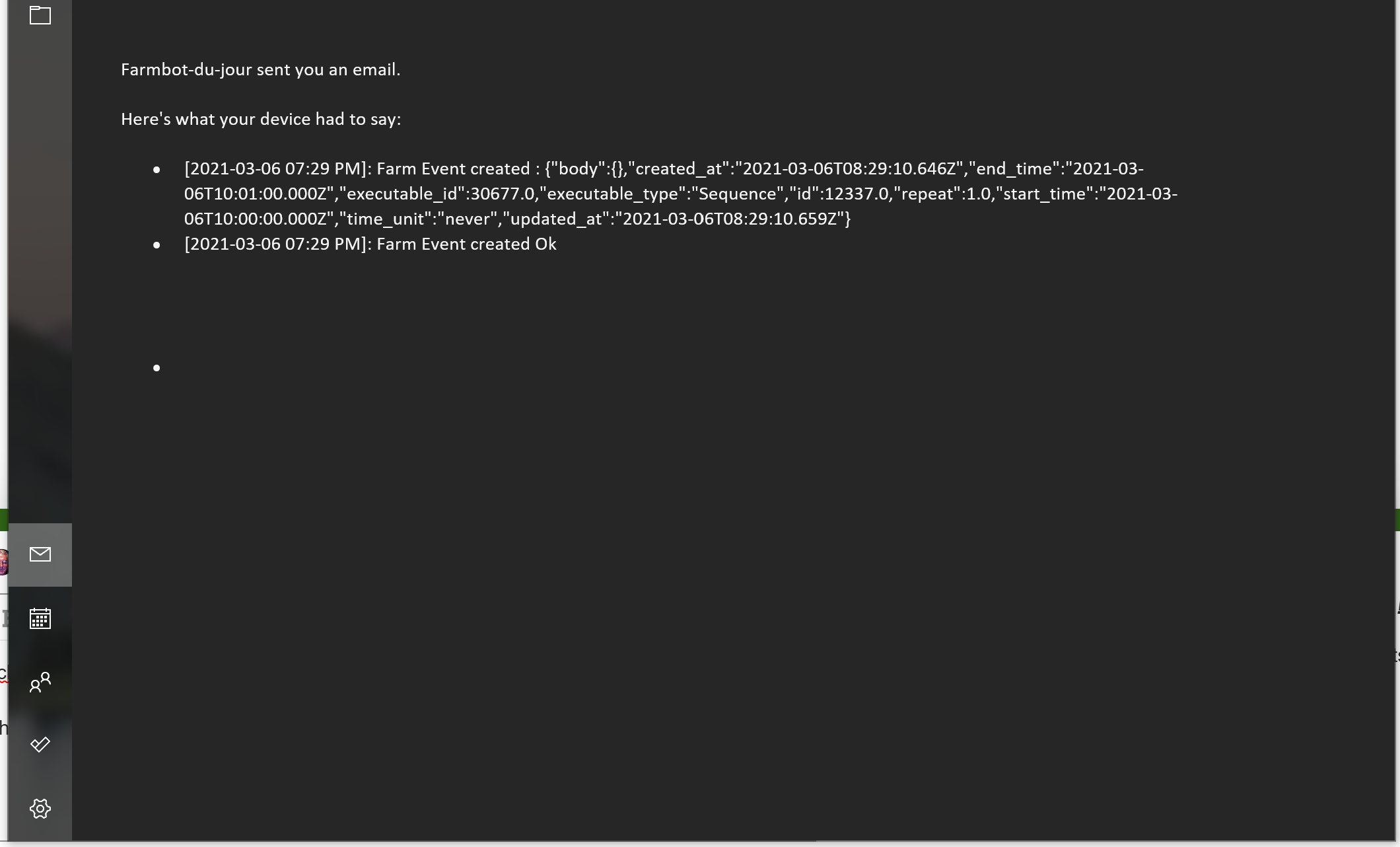

@RickCarlino all working again on outlook.com
( maybe Gee ! Thanks Microsoft ? )
But the latest email notification looks like this. I’ll check my scripts.
