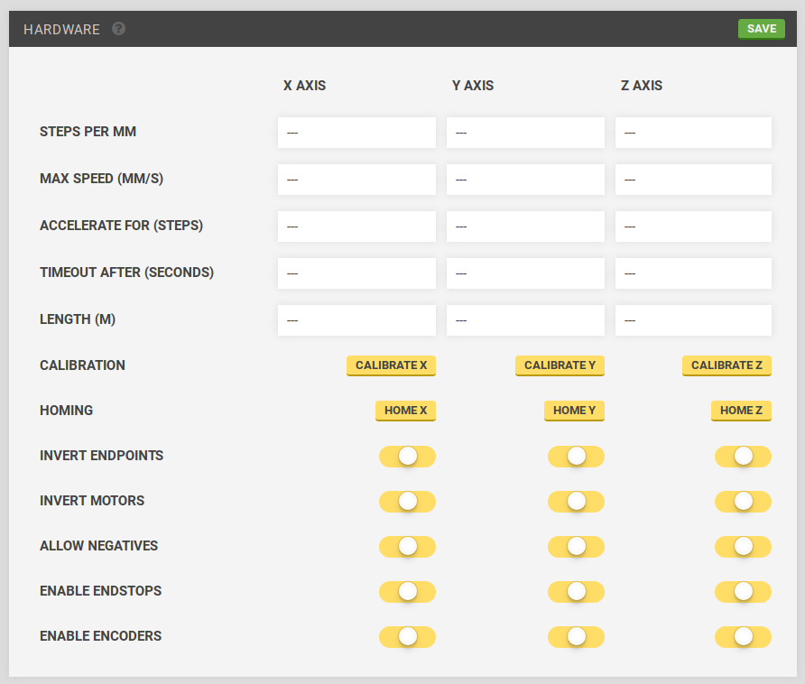

Can you take a screenshot of your hardware widget on the device page?
Found a spider that got fried on the back of the Arduino. Seams to be working fine now. Thank you for your responsiveness.
