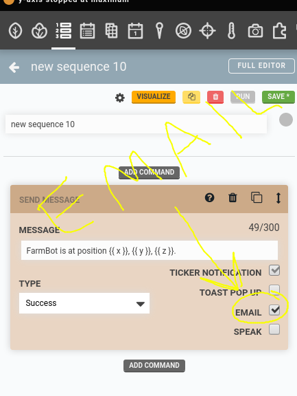

  3. Use the SEND MESSAGE block. Send message allows reporting of XYZ values. I’ve attached an example screenshot below.
SEND MESSAGE BLOCK
