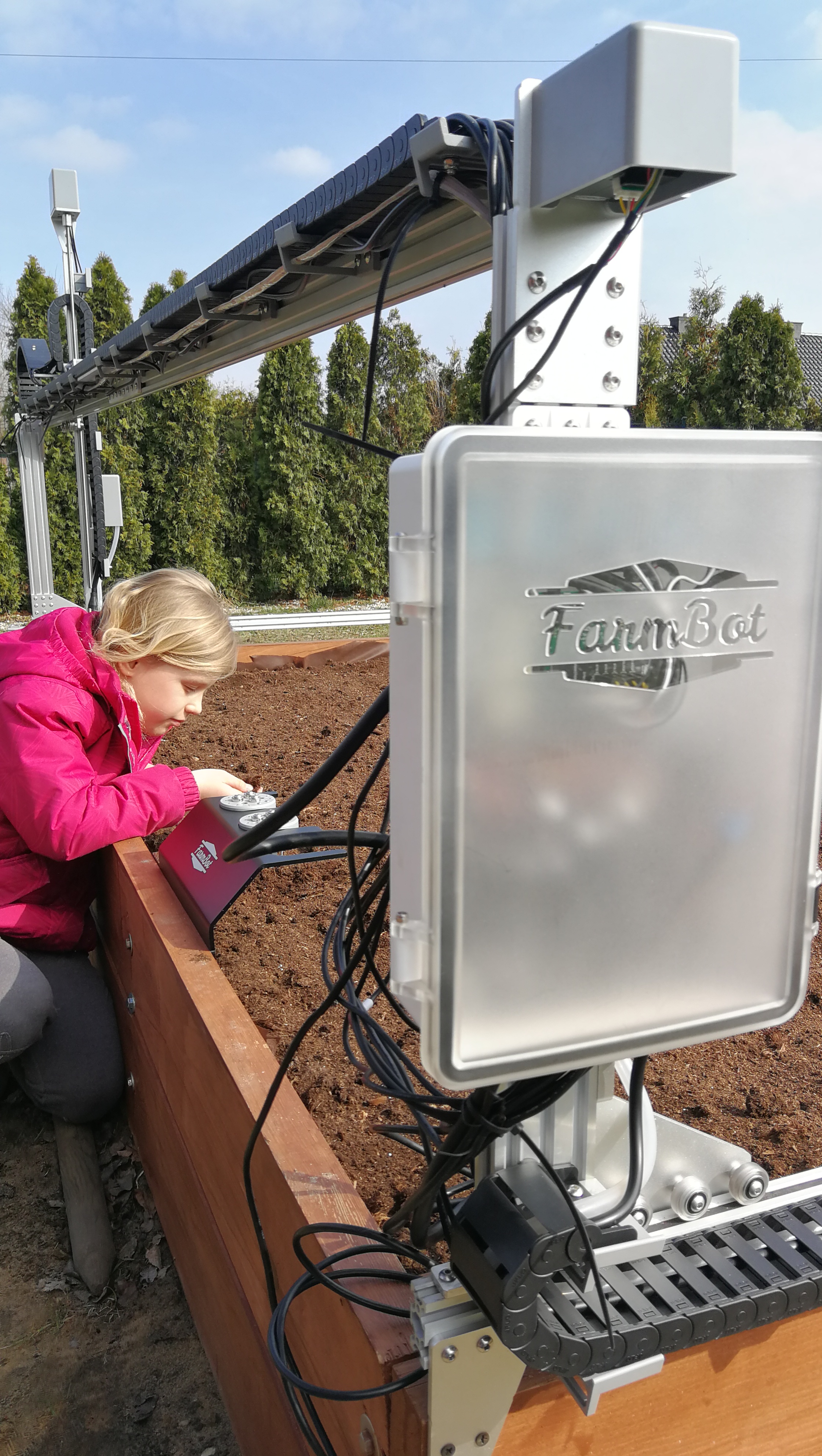

Propably first working farmbot i Poland - city: Sosnowiec woj. region: Silesia :slight_smile:

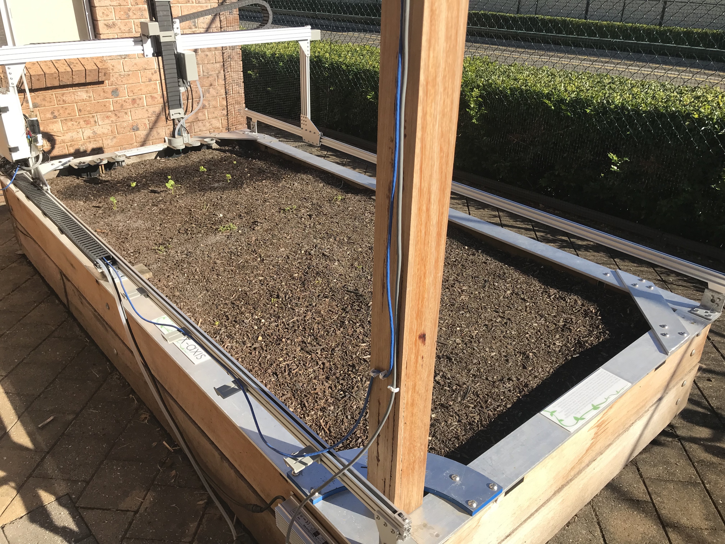

Hi All,
Our farmbot is running on one of three garden beds at my school. One garden is tended to by students during term time whilst the next uses irrigation and a timer.
When the garden beds were made, there was a lot of movement (10mm) in the timber of the beds which would have caused the farmbot rails to become non-parallel. My design solution was to build a floating frame from 100 x 10mm aluminium, fixing it to the timber using T channels and nuts that I made from smaller sections of aluminium.
The watering tool (documented in another post) is allowing the seedlings to be watered gently.
I covered the whole area in netting to prevent birds and other animals from destroying the plants.
Also created some signage explaining to students how the farmbot works.
