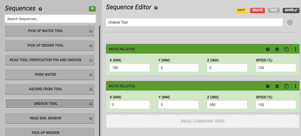

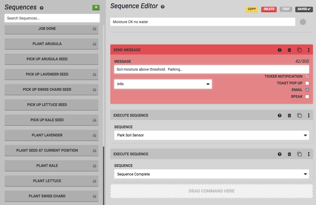

You can set up a sequence that mounts the soil moisture sensor, reads it out and have an if decision to mount the water tool and water if a certain (moisture) threshold is exceeded. You need to find that threshold on your own and I proved for myself that the readings from the sensor are not reliable enough to do this reliably…
