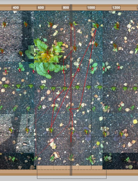

Water All Sequence. Hi I am using this sequence for all the plants in my garden but it appears to be watering the plants in the given location but in a really wierd order so instead of watering a row of closely planted Swiss Chard it moves from one row to another sometime skipping a row etc. any idea why it does this, is this the most efficient track that it has worked out or something?
