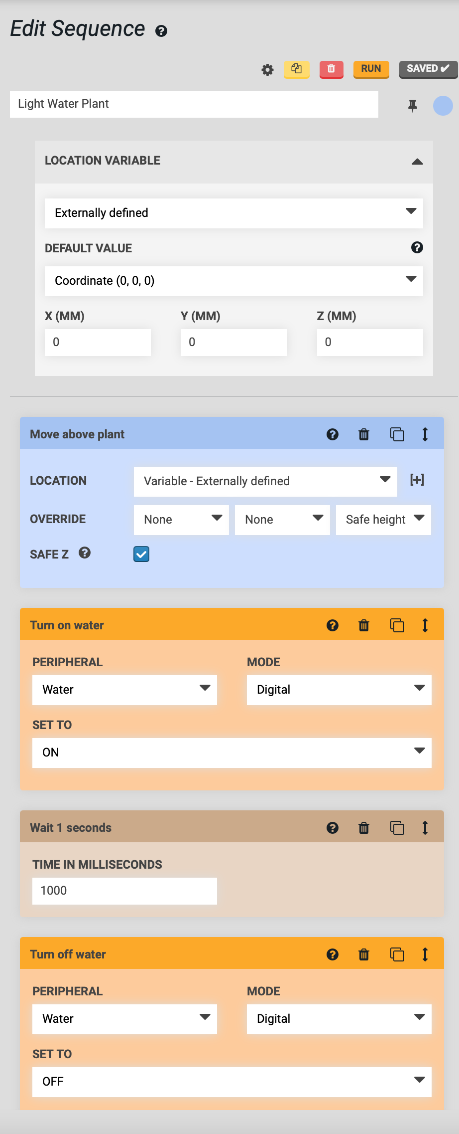

@dlmcshan Can I see a screenshot of your sequences? Are you calling CONTROL PERIPHERAL to turn OFF the water in the same sequence that moves to the plant’s location?

FarmBot OS will actually duplicate the sequence run N times (where N is the number of plants in the group). Because of this, you must ensure that CONTROL PERIPHERAL is turning the hose off within the watering sequence- do you think this could be the issue?
A screenshot would help me identify the issue. Please let me know if this helps.
Here is the sequence I was using.

Thanks for sharing. This helps me understand the problem. I don’t see anything that immediately stands out as user error- it looks like the sort of sequence I have run on my Genesis many times without issue. Although it could still be a configuration/usage issue, it also might be an unreported problem with the software itself.
