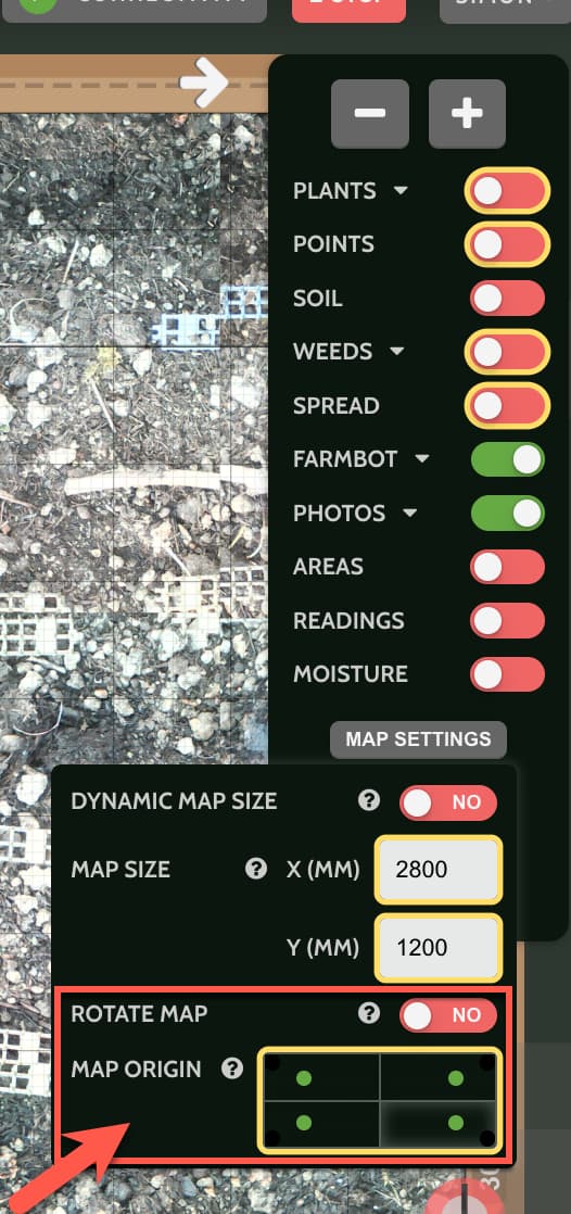

Hi, maybe related to one of these settings…:
Can you check if they have an impact on your issue?

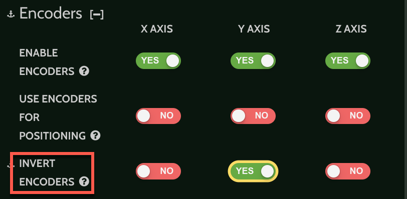

Another reason could be a wrong Encoder Setting. May you have to enable or disable INVERT ENCODERS on the x axis.

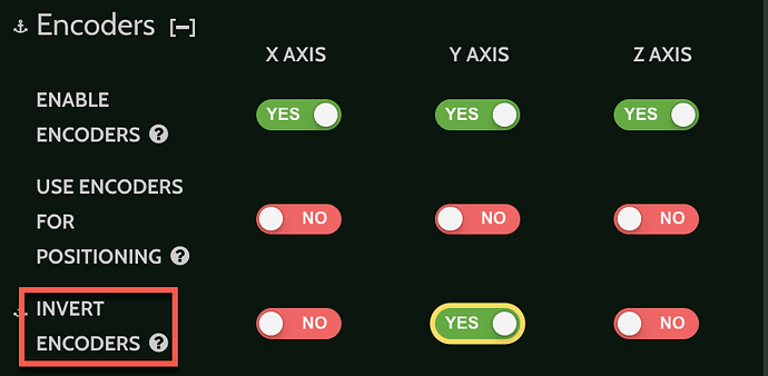

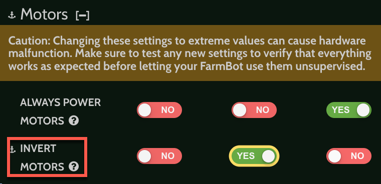

Or these:
I had some similar expirience when setting it up, but can not remember if mine was related to the y axis… At least there I have some none standard configs.
