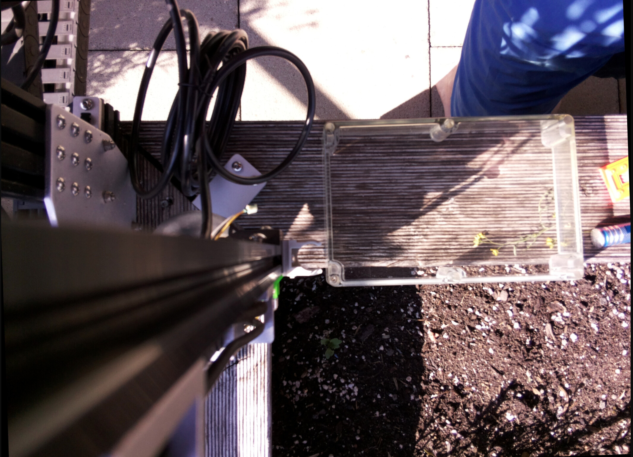

Here is a sample from the camera, I’m experimenting with a few different types to find the best suited one
Cheers Alex

@Outslayer First off, that is really cool!!! :smiley: Thank you so much for sharing this with us. I am very excited to see the follow-up post about how you built it, and also your motivations behind the project.
I’m not sure what happened on the server-side, but currently, we have a 7 MB limit on attachments and the photos above are in the ~2 MB range.
If you can provide the camera model or more specifics about the project (such as steps to reproduce) I could take a look.

Without compression it’s hitting around 5.94mb per photo.
Therefore, it’s possible that when I set it up initially, I hit the upload limit. I will be messing around some more later with the camera so I will report back if I have any problems.

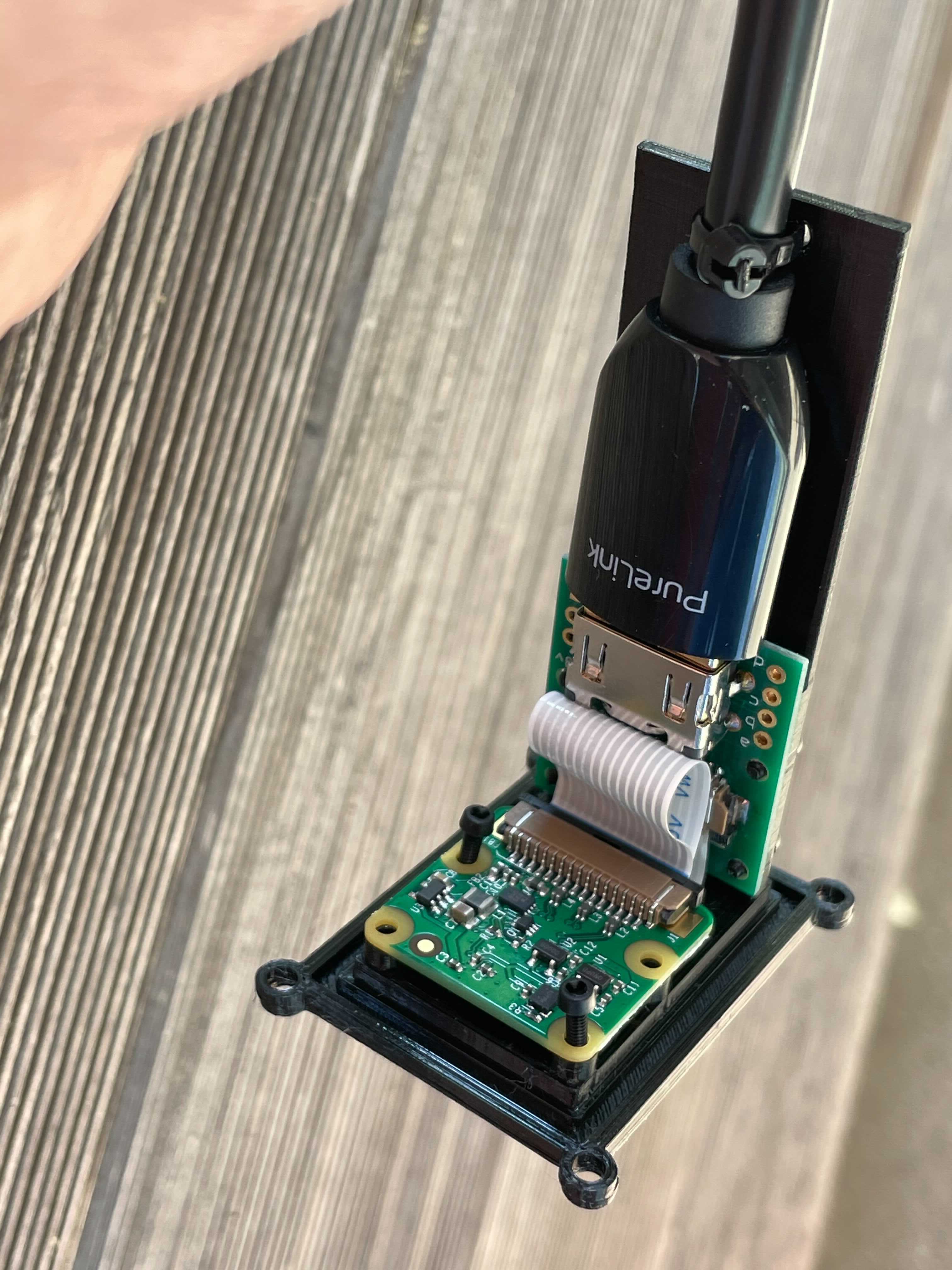

Hey Alex, I am currently experimenting with the V2 cam and the HDMI to ribbon cable adapter. Will keep you updated how it goes, currently printing the (hopefully) water tight grommet :wink:
Hi Klimbim
Cool Looking good.
Looks like the picture is of nice quality too. Keep me updated on how you are getting on.
