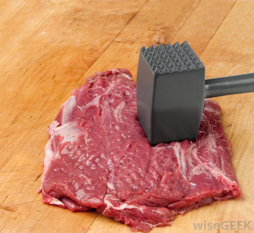

Are you sure you are using a correct term?
The problem with using the word “bash, or bashing” is that it is not referring to a knife or something sharp to do it with… If you were using a hammer or one of these…
You would be using the right term…in English at least.
Bash refers to a high velocity blunt hit… Not the relatively low velocity sharp thing we are talking about! And a knife is a sharp bladed instrument like like we are using… It slices the weed into pieces. Chop? Would be better, but it still gives the image of a fast moving ax or knife to cut it with.
Hope this helps

After some thought and a bit more reading, perhaps bashing a weed is a good idea… Create a two part tool… An actuator with a small meat tenderizer head on it to hit the weed right in the middle, and a corkscrew looking thing to uncompact the soil, loosen the root and aerate the soil…
There would be a disconnection of the weed from the mycorrhizal fungi, but we don’t want it assisting weeds anyway… Only the good stuff…unless it helped our plants somehow! At this point I don’t see how it can!

Stupid enough they started with a bladed like tool. Why bash breaks more of the plants cells so large infection area for items in soil to infect plant and make it critical sick. Yes using a meat hammer on weed plants is surprising effective other than the soil compaction issue.
Issue with chop is clean cut areas plant can heal off better.
Basically you don’t want a sharp knife edge. You want something nice and dull to do the worst cutting job possible. I use bash because you are after either pure bash like boschs tool or you want something fairly blunt. Knife edge is basically totally wrong as it cuts way too cleanly. To put it in prospective wood cutting tools you are after a block splitter blade or back not a cutting axe.

Yes Palomineo you understood exactly what I meant by bash. Chop/knife is less effective than bash against weeds by all field trials. Its funny the things that turn out to be effective.
Even when cutting weeds tops off a blunt tool does a better job than a nicely sharp tool. You use nice sharp tools when cutting plants you want you use blunt horible tools when handling the plants you don’t want. Its all about how well will this cause infection. Yes you clean tools when cutting plants you want and you don’t clean weeding tools that much because you are hoping to introduce infection. If you have weed tea dipping your weeding tools in that also helps kill rate. Nice coating of organisms plant does not want. Bash/cutting weeds is not just about running them out of steam its also about attempting to allow infection to attack them.
Ahh there you go…
Use the meat tenderizer (cut off 6 of its points so it is about 1 cm x 1.5 cm), 2 or 3 quick hits (driven by an actuator) then use the corkscrew method(drill and coat hanger corkscrew) for a few turns to loosen the roots and uncompact the soil! If it comes back green Over the next 2 weeks use the boiling water on it!
Sorry, … the implication was knife, but you said bash! They are mutually exclusive terms. You cut with a knife, you bash with a pipe, meat tenderizer… Mallet, Or even with a $280 titanium hammer(available at the local homedepot, lol)
I did not make the connection of what you were saying until I saw that bosh weeder video and we started talking about meat tenderizers. Lol
