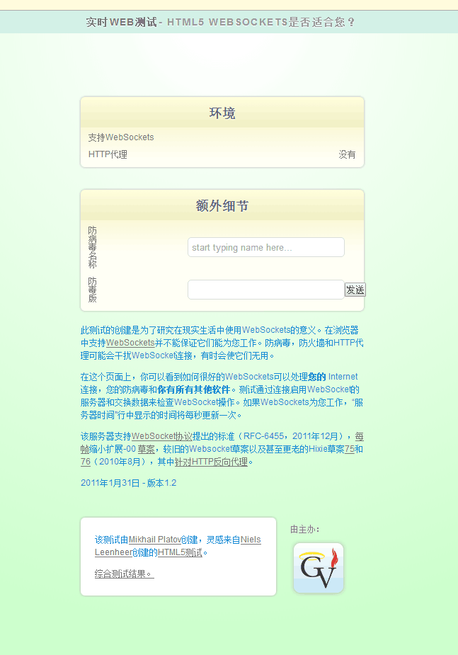

It’s also possible your browser doesn’t support websockets. Make sure this websocket test passes.

I also started seeing this issue about the same time as xiaorong. I’ve tried across three different browsers, each on a different internet connection, including on the one I’m currently writing this. Here are the results of my browser running the afore-mentioned websocket test:
