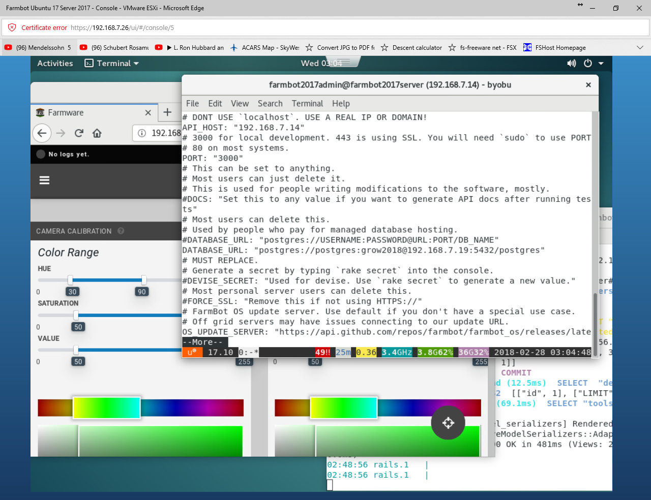

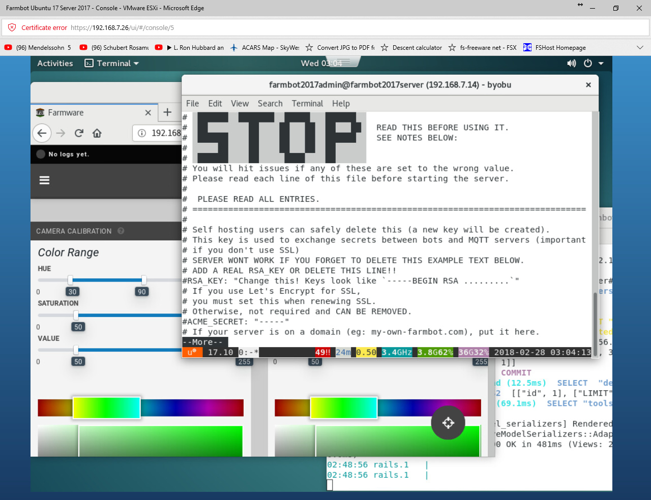

Seems like the rest of the program will work :
Application.yml settings:
