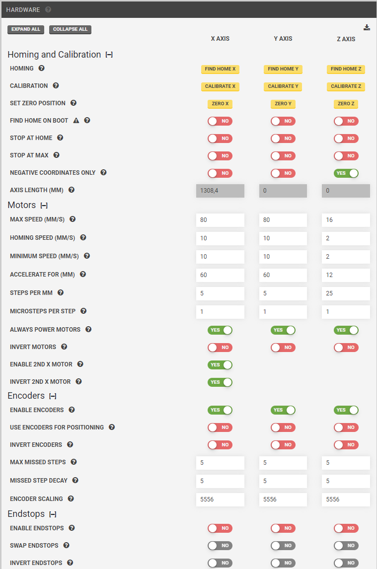

I’m trying to set up my new Genesis 1.4. At this point I want to calibrate the axis, but I cannot press the buttons. They are inactive.
I positioned the bot home and zero-ed the axis before calibration, not sure if anything has to do with each over.
Oh, it seems I need to “ENABLE ENDSTOPS” to make this possible. I don’t think I have that, just a physical endstop.
Or “ENABLE ENCODERS” seems to work, I think I have those. Interface says they are default enabled, except they were not. Maybe because the y-axis motor was not connected on first boot?

Looks like your firmware got stuck somehow when the calibration failed.
You could try to push the RESTART FIRMWARE button in the Device section under POWER AND RESET. If that does not help or generates even more errors you can also powercycle the whole device.
What error came up when the Y-axis was calibrating? Your X-axis was successfully calibrated and the AXIS LENGTH setting was properly filled?
Yes, x-axis value was filled out, just not remembered after the restart. I’ve rebooted the device a few times now.

Looks like your motors can’t get the full speed that is set in the settings. You could try lowering the speed setting, but as this was working with these settings before you could also check the mechanical settings like belt tension and wheel adjustment.
It would be also helpful if you could post an image of your hardware settings in the WebApp.

That is quite normal since the setting ALWAYS POWER MOTORS is active. The Z-Axis always has more load since the tool mount is pulling down by gravity.
Did you try lowering the MAX SPEED (MM/S) setting?

That means that your encoder did not detect the needed count of steps. There can be a few different reasons for that:
So I think that your axis does not move correctly anymore, since you activated the encoders to calibrate. I’d first try to reduce the max moving speed or increase the MAX MISSED STEPS setting.

Lowering the motor speed seems to help, the x-axis calibaration got half way.

I think that rather means that error 0 occured. I didn’t find any information what those error numbers mean, but seeing the Firmware debug message: deactivate motor X due to missed steps indicates that there might be a spot where the axis gets stuck. That might be a bad leveling between those two X-axis profile rails.

Some more testing. All the motors make a little noise when idle. The z-axis motor makes the most sound. See video.
This noise can be turned off when set “Always power motors” to "NO“ , because it is for the motor self-locking
Thanks, will do that. I still think the z-motor makes too much noise when moving, but that’s for a later concern. It has stopped making noise when idle.
