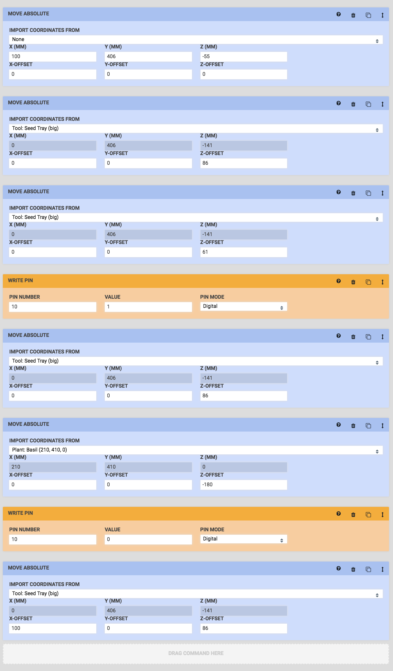

Right at the move absolute command where i have the FB move to the imported coordinates from basil plant ( x210 y 410 z-180).

when i execute a sequence, is the only time FB has movement issues ( stop n go)
I have noticed (but haven’t been able to replicate consistently) that if i re-do the sequence it seems to help.
I had a plant seed sequence from a while ago and noticed that when i tried executing it in a full on chain sequence it would have the same issue, so I copied the sequence and basically just deleted the first command and re-did it and then the one under it ( for good measure) and then it executed without the issue - but as I’ve developed more of my full plant seed sequence, I’ve noticed that the issue has come and gone again.
Additionally, there is also a few specific locations in my sequences that the issue is 100% constant and deleting the problem command within the sequence and then redoing it doesn’t solve the issue.
everything I’ve done for troubleshooting is VERY hit and miss. Some times i think I’ve figured out the reason why, try my solution and then get zero results. Sometimes I’m not even doing anything different just helplessly executing the command in the hopes ill notice something and then it works just fine.
