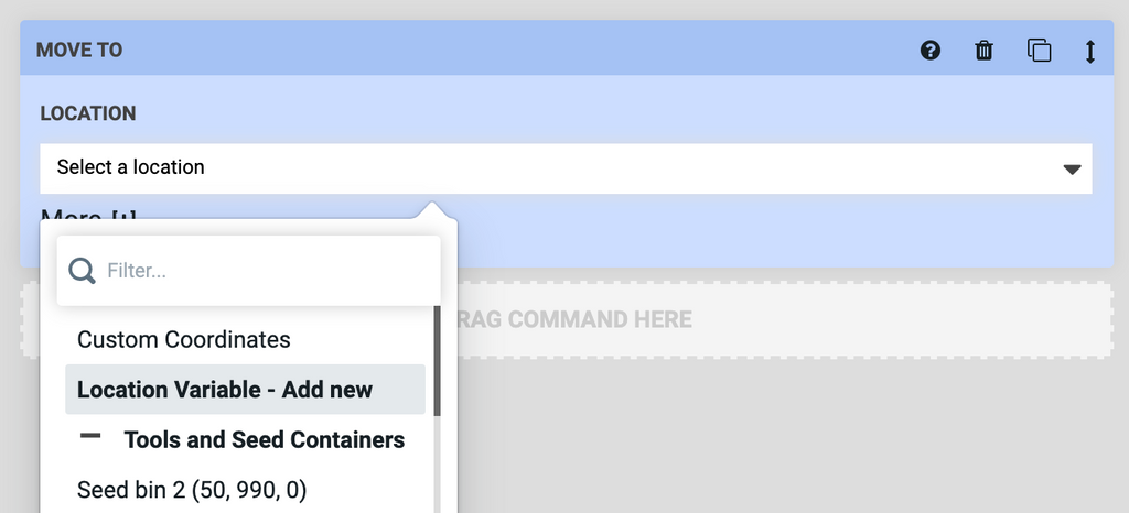

As mentioned earlier, we’re launching with support for one single-location variable per sequence/regimen/event. To create a variable, select “Location Variable - Add new” from the dropdown in a MOVE TO command:
Once you’ve done this, a variable form will appear at the top of the sequence.
From here, you have two options:
- You can define the variable’s value right here in the sequence with Custom Coordinates or the location of a single Plant, Tool or Seed Container, or Map Point.
- You can choose to have the variable’s value defined external to the sequence (in another sequence, a regimen, or an event). To do this, choose “Externally defined” in the dropdown. Note that when you choose this option, you will also need to provide a DEFAULT VALUE for the variable. If the sequence is ever run without the variable explicitly set to another value, the default value will be used.
Once you’ve made your choice, notice that the text in the MOVE TO step’s location field has updated with your selection. If you would like to use the variable in additional MOVE TO steps, you can now find the variable in the location dropdowns.
If you chose option 2 above, you’ve just made your first variable sequence! This means you can run the sequence in different ways depending on the variable value you pass into the sequence from somewhere else. Let’s see what that looks like.
