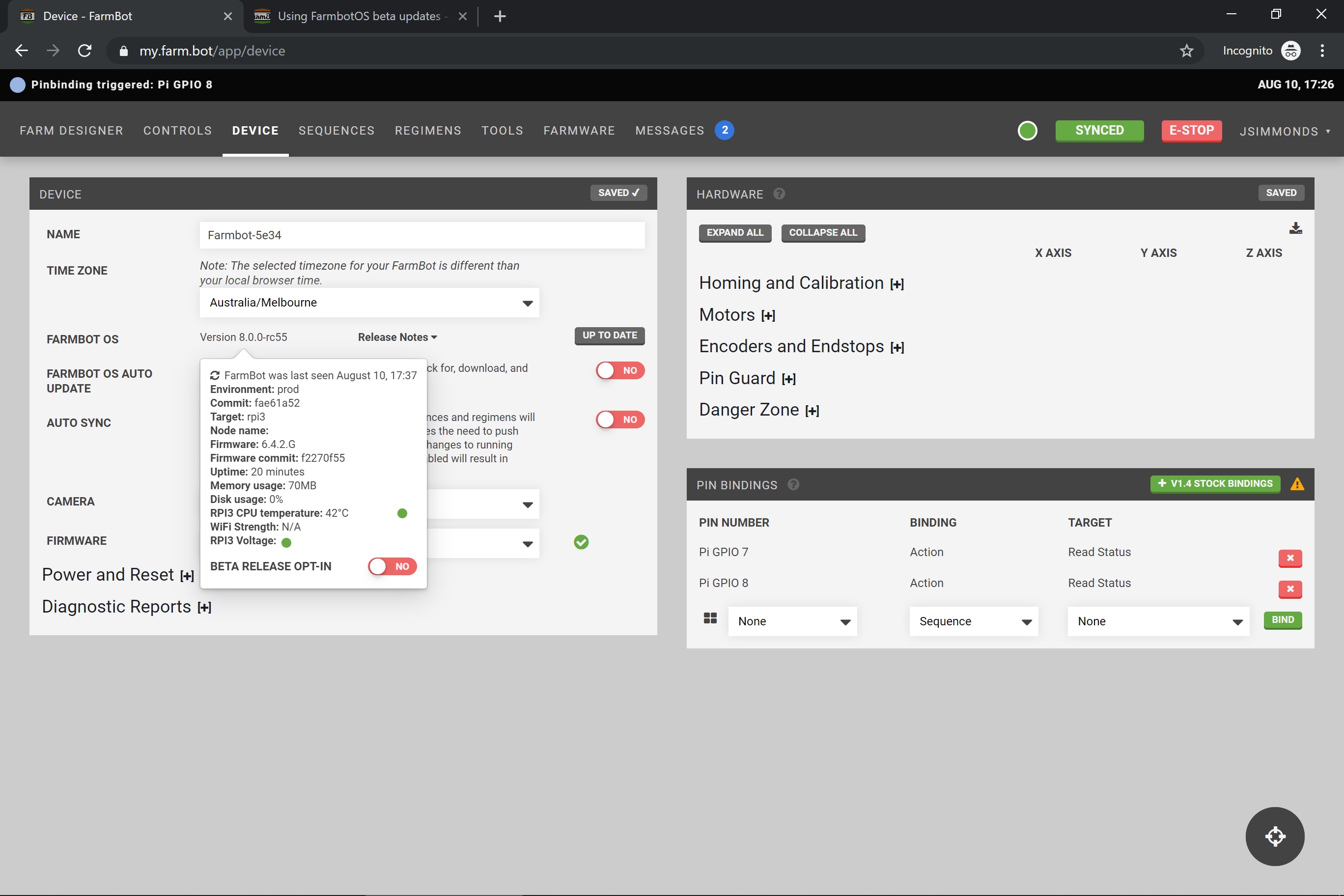

  • SSH Console no longer works . . seems to ignore the configured public key
  • On the WebApp Device page, the little pop-down from the FARMBOT OS version field no longer show the Distribution node name :expressionless:
  • On same pop-down, WiFi Strength is N/A but I’m on Wi-Fi !

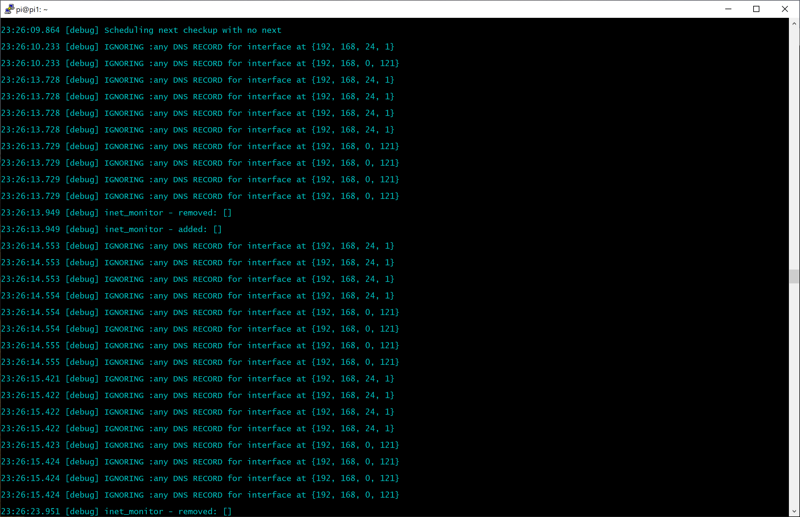

Oh, and I wonder what causes this on the Log . . no side-effects have showed up ( yet ) :slight_smile:

I’ve just released some fixes in RC56 that should fix the following things:
  • reboot causing firmware to not open
  • wifi reporting to the frontend
  • node_name reporting
  • ssh console

Nice ! Most are fixed.

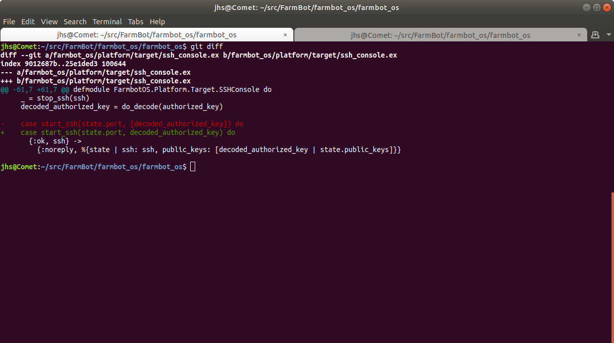

The issue seems to stem from platform/target/ssh_console.ex not using the shiny, new managed FarmbotCore.Asset.PublicKey but rather the older mechanism of the authorized_keys env var from :nerves_firmware_ssh app.

This should be using both mechanisms. Will inspect further in the future

This seems to fix the use of the FarmbotCore.Asset.PublicKey at least . . could you check that it won’t break the intended functionality ? :slight_smile:
Ummmm . . maybe this is better ( though not idiomatic ! )
Hmm looking at what you have, I think I may have forgotten to merge a PR or something. I changed that code I thought
